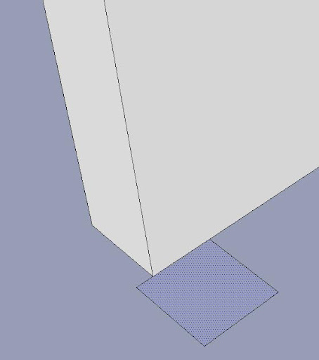

      I´m trying to extrude a profile along a wall.
      http://lh6.ggpht.com/_HpzrAEVRcco/S4ltQ3bZ-oI/AAAAAAAAA1A/JjJS-MdZhAQ/Dibujo.JPG
      As you can see, the shape is closed, and the guide is defined.

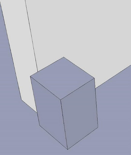

      If I use the Push/pull tool, it works properly. The new volume is correctly created as a separate volume (as I want). 👍
      http://lh5.ggpht.com/_HpzrAEVRcco/S4ltPnxJNlI/AAAAAAAAA04/U-BdaJT2BAQ/Dibujo3.JPG

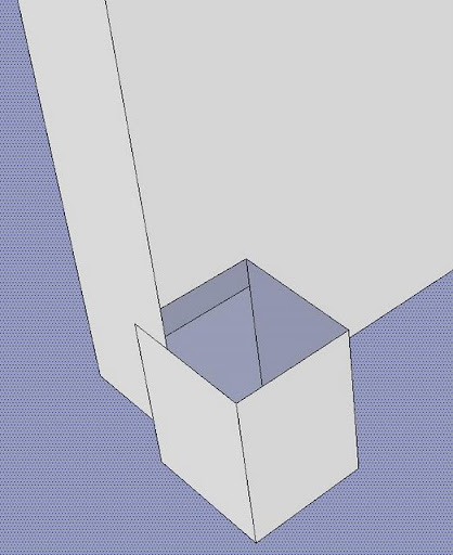

      If I use the Follow Me tool, it seems to work wrong. The volume is not closed, and it erases a partial fraction of the wall. 👎
      http://lh4.ggpht.com/_HpzrAEVRcco/S4ltQNB-YbI/AAAAAAAAA08/z-aqbXDtXHQ/Dibujo2.JPG
