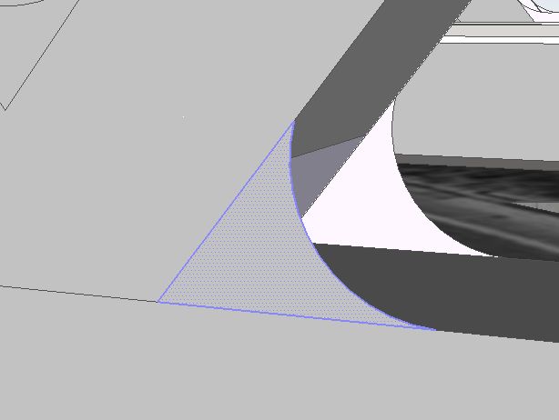

        Most likely, the fasteners (rivets?) you have modeled are the main reason you are getting the "Complex" tag. Considering that when you look at the bridge in Google Earth you won't zoom in to see that level of detail, I would just delete them completely. If you gotta have them, I would suggest using a photo texture or modeling each bolt with only 4 or 6 sides to save file space and using components in place of the groups you have to save space further. Also you could make one instance of a gusset component like in the attached picture (using a 3-sided arc instead of the default 12) and copy for each gusset you need.

        Click for full picture...make the highlighted part into a component.
