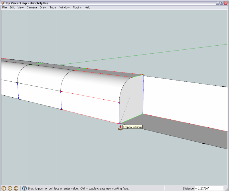

        First of all, I made a group of the two, long pieces so geometry won't "stick" to them. Also, I turned on endpoints in the style dialog so that I can see where I am snapping.
        Then PushPull your face to the nearest endpoint (the image already shows it in progress)

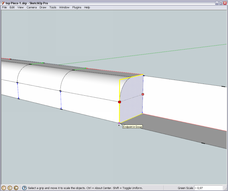

        Then used the scale tool to adjust its width to this endpoint
        Then the scale tool again to adjust its height
        Then go on by PushPulling to the next endpoint and so on until you come up with this (it's already softened, endpoints hidden again and grouped geometry removed as it was duplicated anyway):

              That could be an option but here it was not needed. As soon as I scaled the first "segment", the next PushPull was already not coplanar with it so left a series of edges (if you use Ctrl+PushPull, a face is also left there - then you need to get rid of these inner faces in order to be able to smooth the whole surface).
