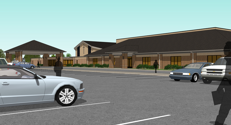

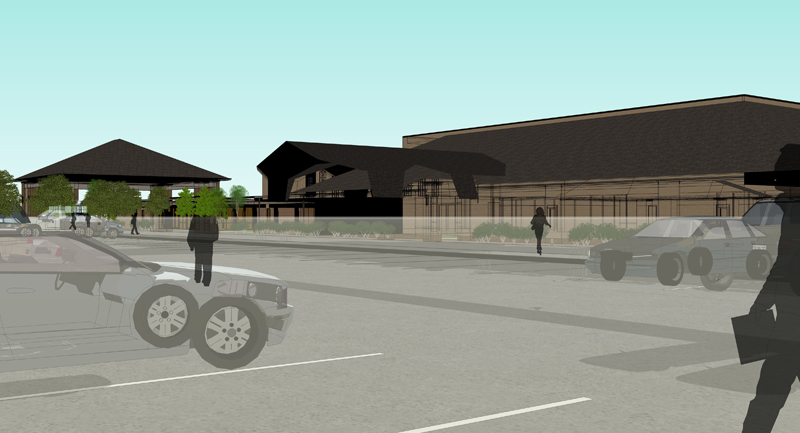

      the first image is exported at 4000x2163
      the second image is exported at 3000x1629
      is this the result of an export size cap or am i doing something wrong?

        Your ability to export large size images will be limited by your hardware. Try turning anti-aliasing off; that usually helps, and probably not necessary at that size. You might also try increasing your virtual memory.

          ok that's helpful. i like to understand my limitations (esp when trying to produce large images for boards). turning off the AA did fix the issue. previously I have received a "failed to save" when i made file sizes to large. maybe the semi-xray condition was just a fluke.
