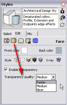

        Open your Styles dialog in the Window menu, go to "In model" (the little house icon) > Edit tab > Face settings and set your transparency quality from faster to medium or nicer (the lowest possible that you already like).
        Note however that this can slow down your computer a bit so I'd suggest to only do this when you want to export something and just leave it at least medium if not faster during modelling.

          Ah! Fantastic! Thanks so much~
