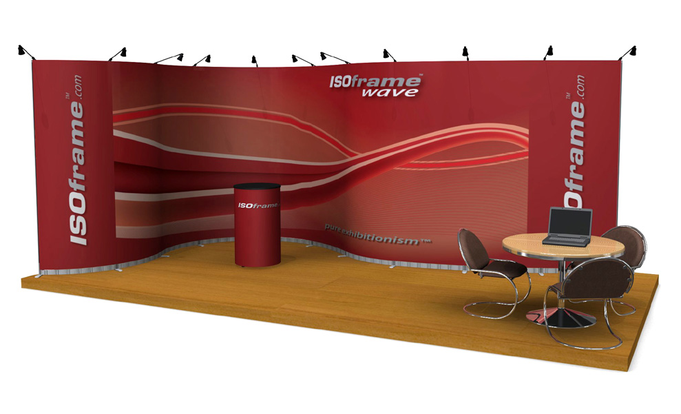

      Please help me, because I can't seem to find exactly what I need.
      How can I make renders like the one in attachment with SketchUp?
      I am not yet familiar with Ruby and plugins for SU, and if one of this is required for this procedure I could need a little more info.
      I know how to put a image on a surface and stretch it.
      Thanks.
      simulation with SU

        Hi!
        You need a render engine for being capable of doing that kind of render.
        There are some render engines for Sketchup but depends on how much money and/or time would u like to pay for it and what quality would u like to achieve .

          Try the Twilight, V-ray and Podium render engine plugins, they're pretty much the best and easiest to use, at a good price. They all have trials, and I think they also have student discounts, so give them a try and report back.
          http://www.twilightrender.com/
          http://software.asgvis.com/index.php?option=com_content&view=article&id=297&Itemid=199
          http://www.suplugins.com/
