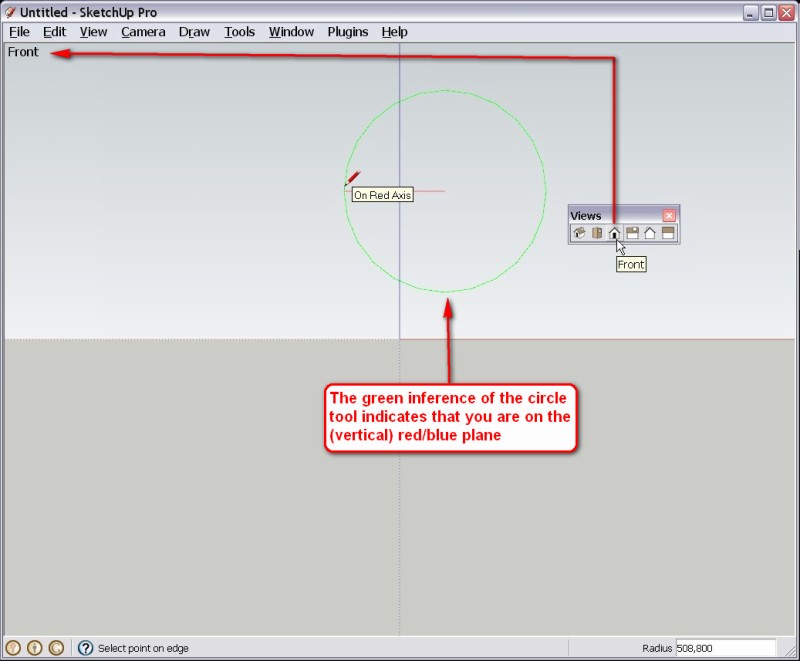

                There is this "Standard views" toolbar - whith which you can always navigate to any special view. Note that while in an emty model, drawing would be made basically on the red/blue plane, if there is any model element in there, "in the depth", SU will tend to snap to those, too.

                    If you want, you can even set up scenes with certain views (and even camera settings like perspective/orthogonal) and by clicking on these scenes, you can easily navigate between the different views.
