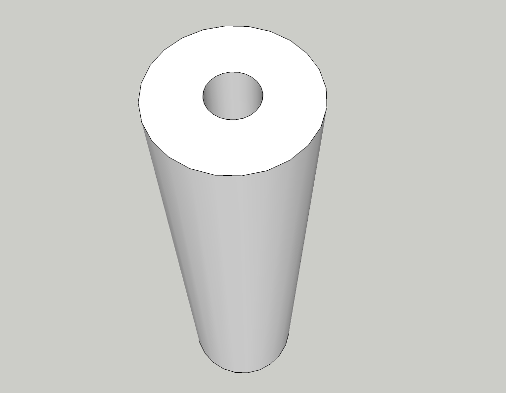

        Hi Emil,
        I don't exactly know what you mean but here is what I could figure out from your description:
        Tube.skp

            • A Offline
              Airsofter
              Yeah close enoguh just the ID need to be smaller and it needs to be opened i one end.
              But that is just the "template" If anyone could make some cool designs like, curves, holes and different forms of the silencer.

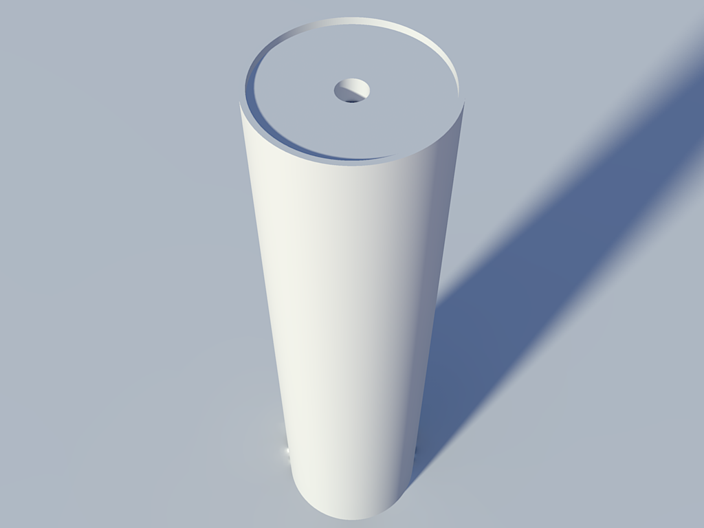

              • GaieusG Offline
                You make an octagon with the Polygon tool which is a hexagon by default but if you type 8s (for eight segments or sides) and hit Enter, it will become an octagon.
                The same goes for the circle (24 segments by default) or the arc (12 segments by default) tools.
                If you want really smooth looking curves, model with higher poly circles/arcs. However note that this will soon tax your computer seriously. This "shot" was made with 96 segmented circles (and respectively, cylinders).
