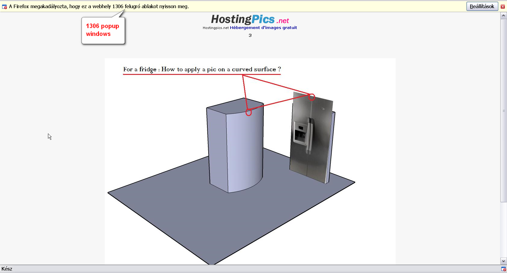

The image hosting site you have your images on tried to open thousands of popup windows in my Firefox. I was curious what is so important for them to communicate with me and a rather heavy flash animation wanted to load.
Could you rather attach your images straight here rather than expecting members to click and visit sites like that? Thanks.

Me too. This is the window I got with the site (and that number was RUNNING like a madman, believe me, my friend). The screenshot was made at 1306 popups but when I finally killed it, it was about 7,000 something.
(Of course, this is only the attempt of opening the ONE SAME window - just several times - but it is actually a hatred thing to experience such an aggressive way of doing it)
