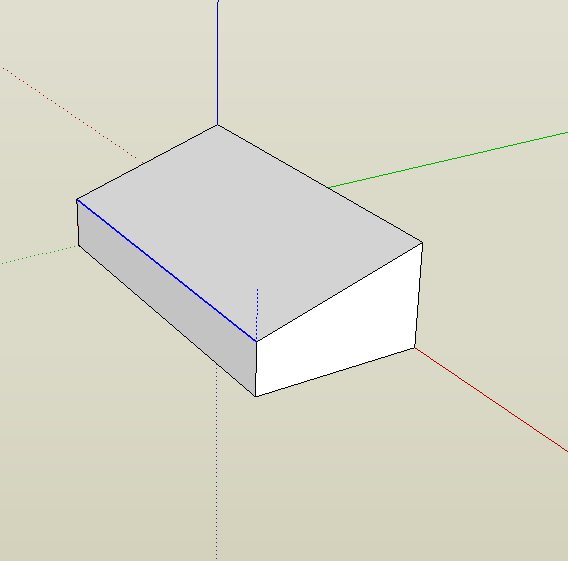

      I'm trying to make an object that contains angled planes. The image below shows a partial made shape that I'm wanting to make a solid object.
      http://img197.imageshack.us/img197/818/43245569.jpg
      The only way I currently know to do this, is to first make a larger shape, then cut away sections using planes and the 'intersect with model' function. Is there a much easier way to do this?
      Thanks.
        remus
        Could you go in to a bit more detail about what your aiming for? theres a few ways you could make that in to a solid shape, although all would involve adding some 'extra' to your shape (because of the overhanging section on the left.)

            first of all only make one button then copy that one ten or twelve times whatever. should probably be a component so if you modify one they all change.
            so, the easiest way to do this if i understand you is to make a cube then lift or lower the edges (with the move tool) individually.

              xrok1,
              Thanks for the solution.
