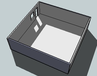

        Hi Jesse,
        First of all, you should georeference your model and save it as a template. Let's see...
        1. go to Window > Model info > Location and set your custom location there. Should be easy if you know where exactly you live (Lat/Long)
        2. Go to File > Save as template...
        3. finally Window menu > Preferences > Templates and here choose the custom template you've just created.
          From now on, any time you open a new SU file, it will be located exactly where you live. You can also open the Shadow dialog from your Window menu and play around the shadows at different times of the day or year. Even make animations showing them from sunrise to sunset (or from December to June).
        I haven't used that particular plugin yet (although read about it) but seen another one here:
        http://sketchuptips.blogspot.com/2008/02/sun-tool-preview.html
