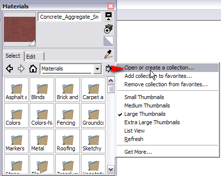

            Also, "we" have this option, too, which should be there (somewhere) on the Mac as well (but these dialogs are the ones that differ the most)

              Thanks, I'll check that link. I know I don't have that icon to the far right like you have shown in your example though. I hope I can find out how to do this - seems crazy to imagine it not available.
