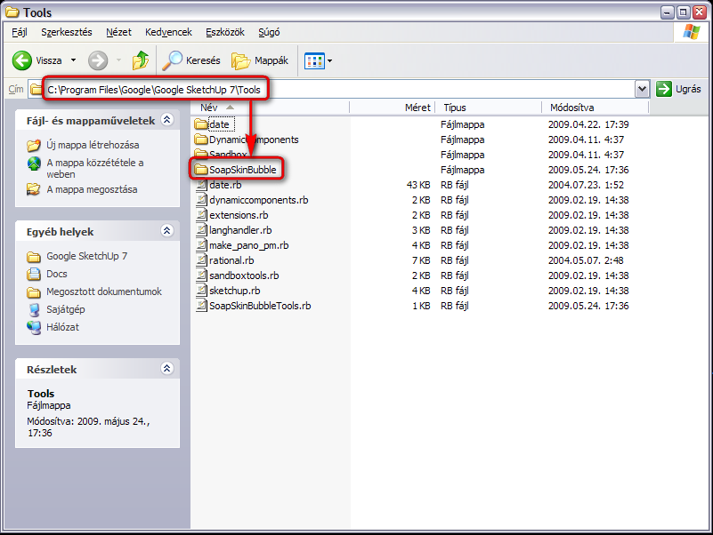

            @remus said:
            All plugins go in the plugins folder, regardless of what theyre called...
            Well, except at least one: Soap, Skin and Bubble which goes to the Tools folder although that's indeed rare.
            • Chris FullmerC Offline
              Chris Fullmer
              Soap skin goes into the tools folder? Thats not right. Does Josef have an installer with it that puts it there? @Last or Google or whoever it was at the time specified that the tools folder was only for their use and plugins folder is for all other plugins.
              All my Plugins I've written
              • GaieusG Offline
                Well, at least that's where I keep it:
                I swear I've seen installation instructions on his site but I cannot find them now.
                Well, what can they do about it? πŸ˜›
