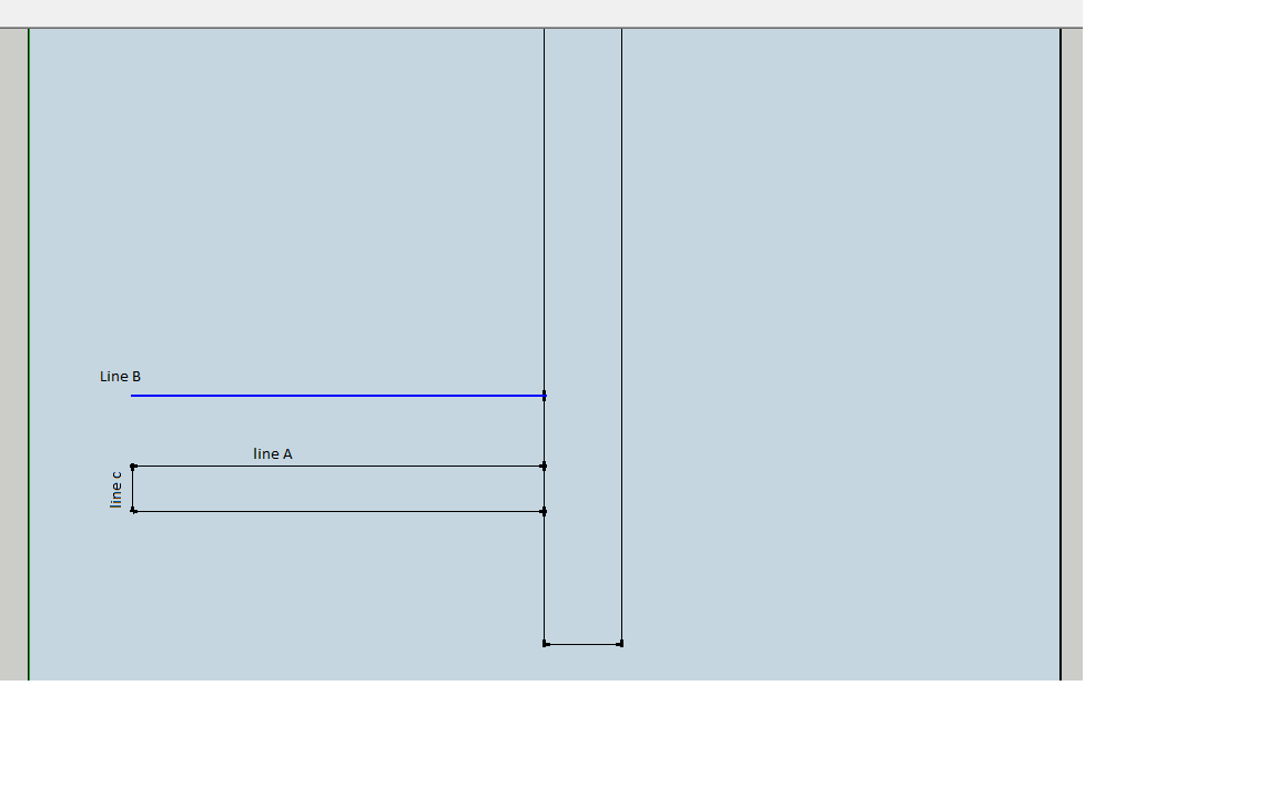

                  fiveohhh
                  In the picture attached; say I wanted to draw line B 5" off of line A and snap it's length to the vertical extension of line c. In solid works I could just draw a line and it would snap the correct length(if it didn't snap you could define that relation later), than just smart dimension the line to be 5" off of line A. If I ever needed to change that 5" I could just redefine it.
                  To do this in SU I need to extend line c up with a line or using the tape measure, than I use the tape measure to draw a line 5" off of line A. Than I can draw my line. I than need to erase my tape marks. if later on I need to change that 5" to 4" I just put the new dimension in where the old was was originally dimensioned to.
                  When working with whole numbers SU isn't too bad, but I want to make a line that is 1.1357" off of an element down to .9342" I don't want to do the math in my head nor do I always know what the original(in this case 1.1357") dimension is in my head. I'm assuming that I didn't relay my point very clearly... I think I confused myself trying to describe it, so let me know if this doesn't make sense.
                  • GaieusG Offline
                    So what I'd do here is:
                    1. Select line A
                    2. Select the Move tool and press Ctrl
                    3. start "Copy" moving line A upwards
                    4. type 5" and hit Enter.
                      OR
                    5. at where line A meets the vertical line,start a line on top of the verical one, type 5" and hit Enter.
                    6. as now you've established the starting point of line B,start a line from there towards the left and let it snap to the end of line A (to be equal length).
                      Indeed totally different logic, but when you are in 3D (and not just 2D like in this view), starting off things on existing geometry and then using other existing geometry for reference is what makes SU very easy and intuitive.
