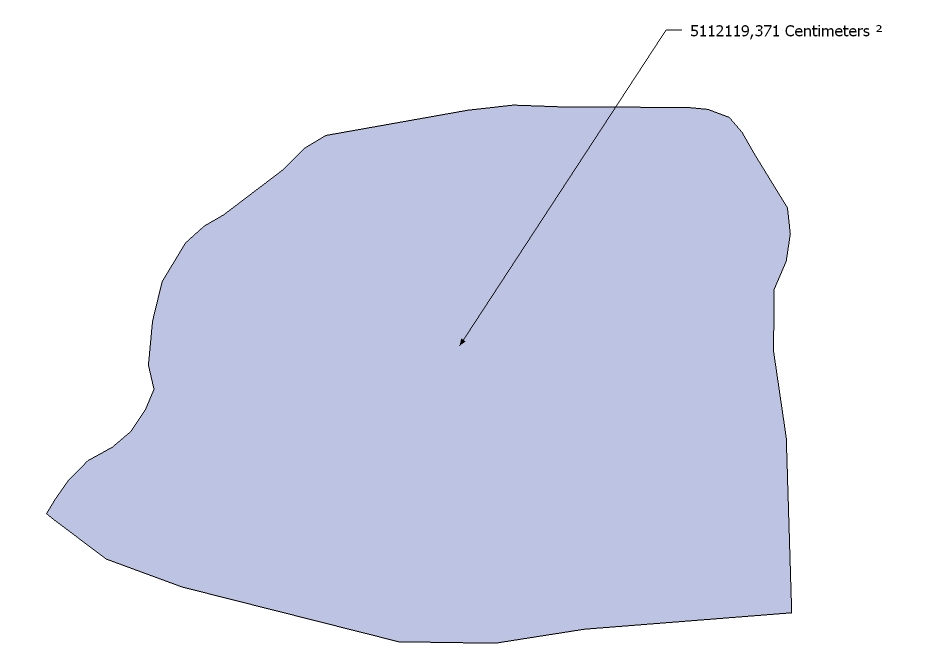

        Hi Malakaii,
        If you draw a shape - any shape in fact - in 2D and use the text tool on it, it will tell you how "big" that area is.
        Note that my template is set to centimetres but of course,you can use nay units.
        Now of course,you can start dividing this area into whatever you want but I'm not sure what exactly you menat in the second half of your post- but let's "start" here at least.

          Hi Malakaii, hi folks.
          The area that you get as the default text when used on a surface is not associative. You will have to delete it and add a new one for each of the internal boundaries that you will create.
