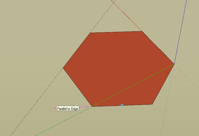

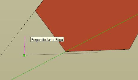

            there is parallel and perpendicular (purple line) inferencing as well if you hold (hover) your draw tool over an edge. if those two solutions don't work for you then you got me. oh, one more thing that may help is construction lines. make them with the tape measure and protractor tools.
            • X
              xrok1
              here is a construction line and a parallel inference:Capture.JPG
              here is a perp. one: 😄Capture2.JPG

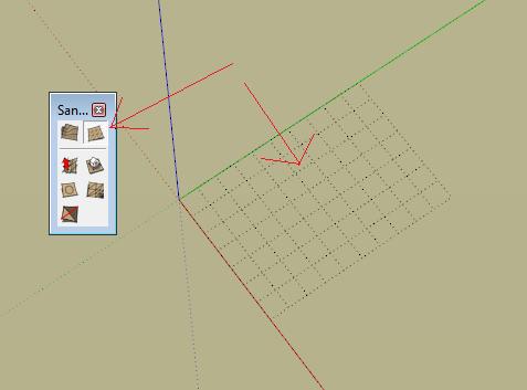

                        but if you insist that you want a grid just drag one out with the "sandbox->from scratch" tool?
