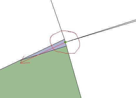

        i'm not sure if this is what your asking but, your problem is circled in red, draw a line in the direction shown to the next intersection and the faces will close. also you should split the model in half and make a component, then mirror it. half the work and problems.
        PS you have a lot of reversed faces.

          Thanks !!! 😍
