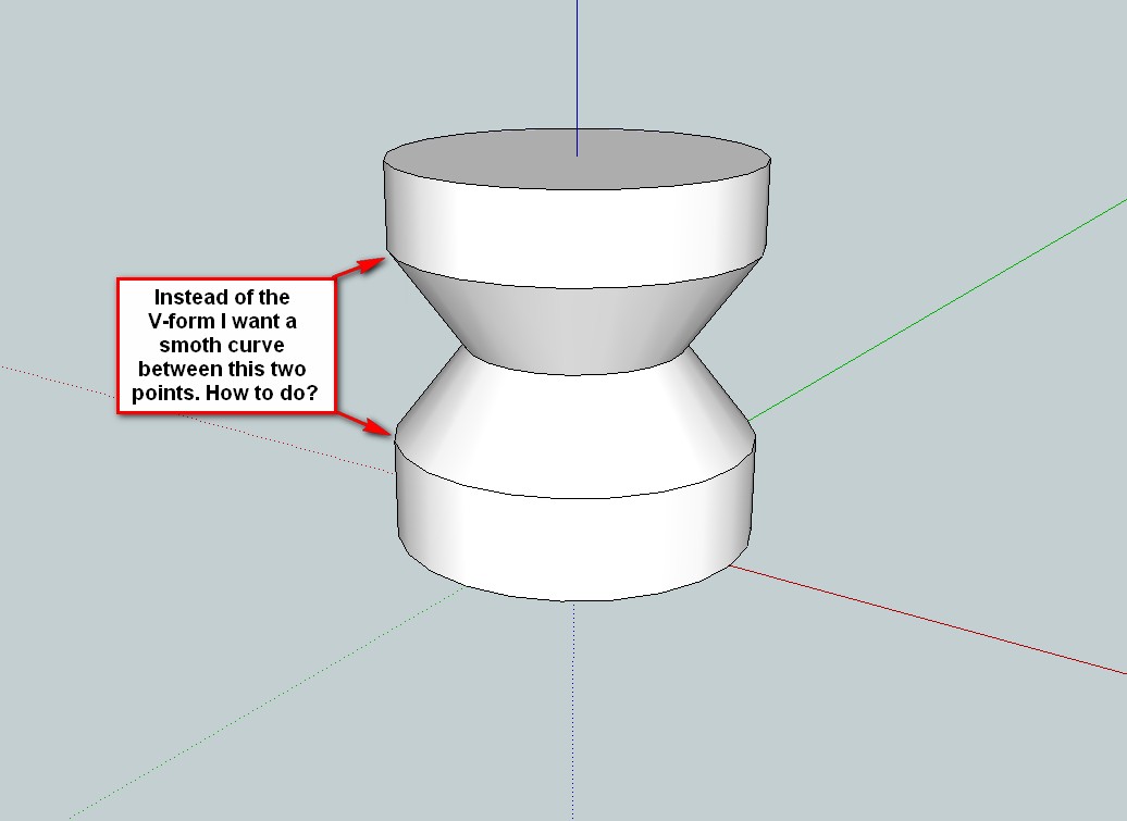

      I have a cylinder and want to do an intake? in the middle but want it as a smoth curve, not a V-form.
      How can I do that?
      Regards

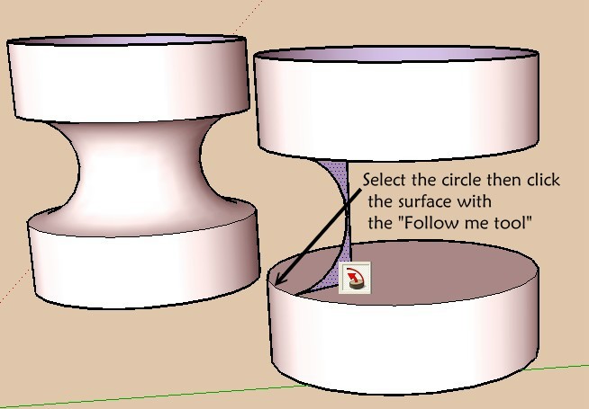

        Maybe like this 😉

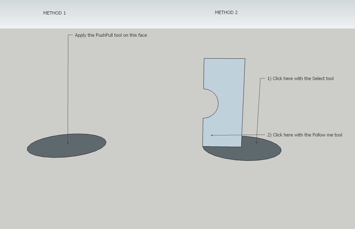

          You probably drw a circle and then PushPulled it up to a cylinder.
          In order to draw a shape you would like, you need to approach the whole differently, lathing a profile shape around the circle with the Follow me tool
          See example file attached and follow the two-step instructions under
          METHOD 2.
          CurveOnCylinder.skp
