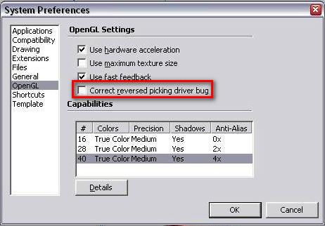

        • Chris FullmerC Offline
          Chris Fullmer
          There is an option in
          Prefences>OpenGL>Reverse Picking bug or something like that. That should fix it!
          Chris
          All my Plugins I've written
          • GaieusG Offline
            What Chris says...
            Check that box
