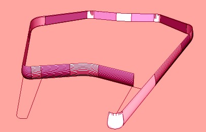

      I am having some trouble in using the follow me tool. The segmented curve profile gets bunched up and intersected with one another in the corner rounding area. Is there a way to clean up the form? or is there a ruby script that will allow me to skin the profile. could use some help! thanks

        Generally "face" must be perpendicular to the line start
        So rotate it, Select the path, then click the surface
        Of course depending of the form of the path and the profil of the surface intersections can be produced πŸ˜‰
        Here the path is also built with some segments of lines, you must weld them with a plugin before Weld.rbby R Wilson
        Crossings is of course source of problem πŸ˜„
        If you want skin you can use this
        Skin22by D Belvin
