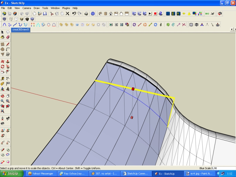

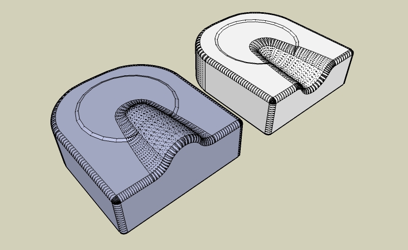

        Is this what u are thinking?
        It took a little to make it.
        I used follow me and scale.
        Ex.skp
        Elisei (sketchupper)

          • ely862meE
            ely862me
            the corner is easy to make with follow me,just draw an arch and use the follow me ,
            later u must use the follow me and the scale tools

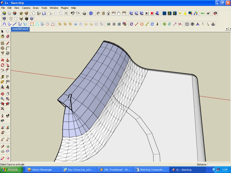

              • ely862meE
                ely862me
                i used 2 follow me:one for the connection part(at the base)and later i play with all section with scale tool ,and one for the upper part and again used the scale tool for all sections
