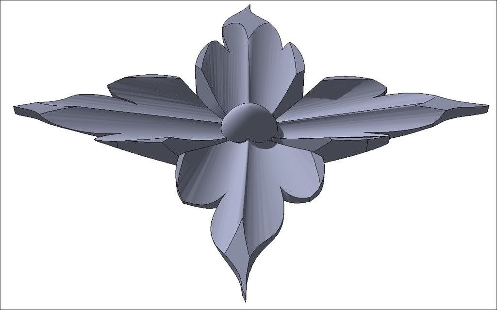

                      And now the Square Flower.
                      This time, i havn't made any video, but just a bunch of *.skp . The reason for this is that there is no new technic to explain in this achievement. (But if something is not clear enough to you, let me know and i shall make a partial video enlightment.)
                      I have deliberately drawn a complex flower with not a single mirrored petal, but with four petals imitated from one of the original flowers.
                      http://i274.photobucket.com/albums/jj245/Spendauballet/BritainKiki/CP_SquareFlower_thumb.jpg
                      http://i274.photobucket.com/albums/jj245/Spendauballet/BritainKiki/SquareFlower238_thumb.jpg
                      SKP: StepA
                      http://i274.photobucket.com/albums/jj245/Spendauballet/BritainKiki/CP_SF_thumb.jpg
                      , StepB
                      , StepC
                      , StepD
                      And a small Video just for the pleasure of assembling the parts:
                      http://i274.photobucket.com/albums/jj245/Spendauballet/BritainKiki/CP-TestAssembl_thumb.jpg
                      I'd like add a really cool and(relatively) new script to my previous list and introduce:
                      [Plugin] Round Edge - v1.0 (by Bezier) by Fredo6
                      :-)simon
                      • simon le bonS Offline
                        simon le bon
                        Hum! I've realised my SKPs do not explain as well as i wished. So i have changed my mind.
                        So here is three partial video steps in order to make the
                        - - SquareFlower - -.
                        http://i274.photobucket.com/albums/jj245/Spendauballet/iSimon/engine.gif
                        Drawing a Petal(Sorry Didier and Fredo to have reversed your plugins, BezierSpline are not from Projection tools pack but from BezierSpline tools pack from Fredo6 with credits to Carlos António dos Santos Falé for the Cubic Bezier algorithm )
                        Carving a Petal
                        Dealing with the Chamfer
                        :-)simon
