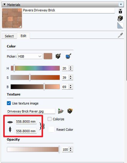

      How can I obtain the length and width values from the material panel using the SketchUp Ruby API?
      I’ve checked the official SketchUp Ruby API documentation, but I couldn’t find a method that solves this issue. I also tried searching on Google and with AI tools, but still haven’t found an effective solution.
      See the image below for reference:
      If anyone has experience with this or knows how to retrieve these values through the API, I would really appreciate your help!

        I am not a SU Ruby expert, but I think you can get and modify the dimensions for only those materials which has texture assigned to them and they has been added to the model. Then you can use Sketchup.active_model.materials[x] to get the material and then you can modify it's attributes.
        Others might have better ideas...
        K 1 Reply Last reply Reply Quote 0

          Here is a little snipet
          Open the console, load the RB and type: matTexture
          def matTexture()
          	model = Sketchup.active_model
          	materials = model.materials
          	mat = Sketchup.active_model.materials.current
          	mat_name = mat.display_name
          	texture = mat.texture
          	if texture
          		t_height = texture.height
          		t_width = texture.width
                          UI.messagebox( "Material " + mat_name + "\n\nCurrent size:\n" + "Height: " + t_height.to_s + " inches\n" + "Width: " + t_width.to_s + " inches")
                  else
                          UI.messagebox("No texture applied to this material",MB_OK)
          	end
          end
          Please select a material first
          Retrieved values are in INCHES
          Hope this helps
          DB
          K 1 Reply Last reply Reply Quote 3

            @Gábor Thanks for the suggestion! I actually tried this before posting, but it didn’t give me the length and width values I was looking for.
            Still appreciate your help!

              @Didier-Bur Awesome, thanks a lot! Your method worked like a charm — exactly what I needed.
              Really appreciate your support!
              Cheers!

                Above is a little enhancement: select the material before typing matTexture in the console.
