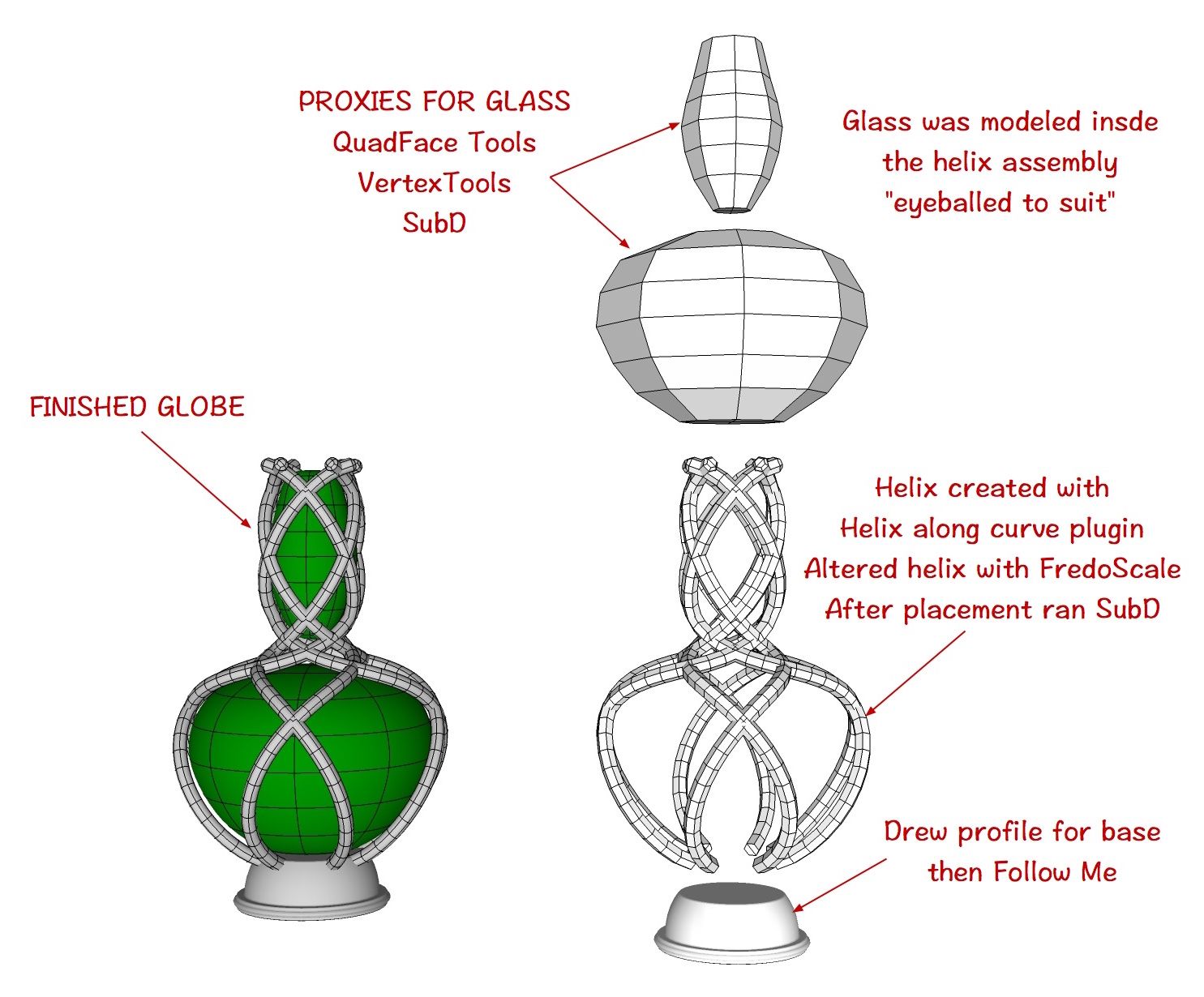

                      @ntxdave Practice and experiment. That’s how you get there. To answer questions you asked over in my thread. You can manipulate geometry with various tools like FredoScale and VertexTools. Box has numerous posts in his tutorial thread showing how to use the various tools in FredoScale. Also posting an image,of one of my models. Exploded the parts and gave a brief description of what I did.twist globe exploded.jpg

                        @tuna1957 Thank you. I thank you for the reference to the FredoScale tool and its ability to twist. It helped me begin to visualize some things like you have been doing. I just need to practice/experiment more. 😁 😁
