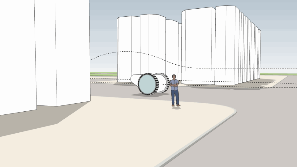

          Example 3 of the camera motion simulation: linear camera motion -
          controlled via a "Slider Controller" in the "MSphysics Control Panel".
          Add a "Piston" joint at a position you like to start the linear movement of the camera.
          Place the camera object at the desired camera start position (near the Piston joint).
          Delete the Motor joint or disconnect it from the camera object if it still exists.
          Connect the Piston joint to the camera object with the MSPhysics "Joint Connection Tool":
          • click on the "Joint Connection Tool" in the MSP Toolbars
          • select the Piston joint with the green arrow
          • press the "+" key and add the camera object to the selection ("-" key to disconnect a joint).
          In the attached file the Piston joint moving the camera is already equipped with a Slider Controller.
          Now it is possible to control the linear movement of the camera during the simulation with the slider.
          Record, Play and Export with MSPhysics Replay functions if you want.
          MSP-Tut_CamLinFix_Slider_P3.skp

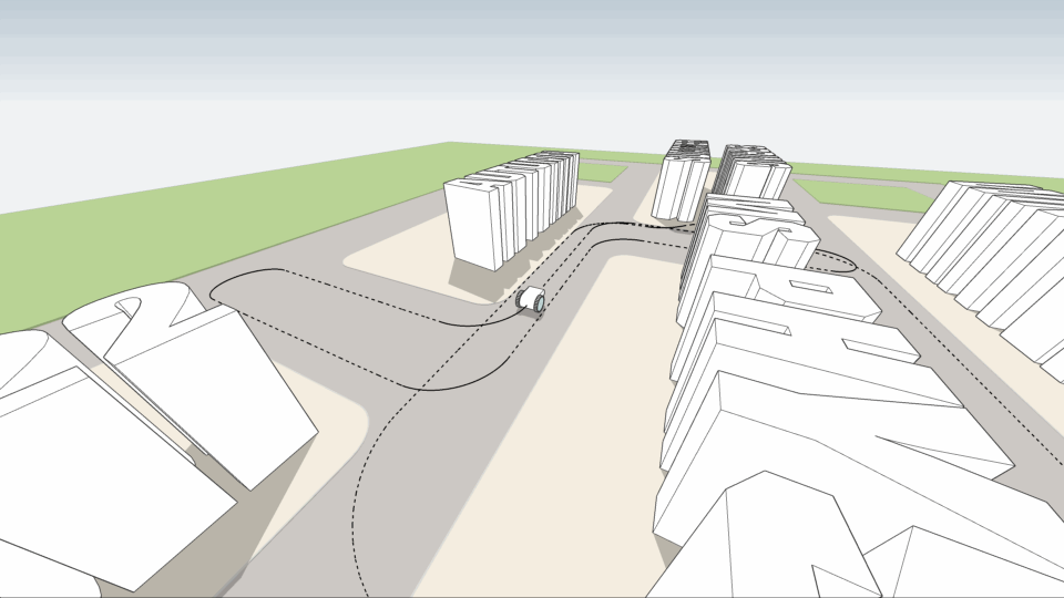

            Example 4 of the camera motion simulation could be the basis for path bound camera flights.
            Again controlled with a "Slider Controller" in the "MSphysics Control Panel".
            Add a CurvyPiston joint at a position you like to start the flight of the camera.
            Connect camera and joint as described in the posts above.
            Everything is prepared in the attached file.
            The CurvyPiston joint moving the camera is already equipped with a Slider Controller.
            Have fun trying it out!
            MSP-Tut_CamCurvyPiston_P4.skp

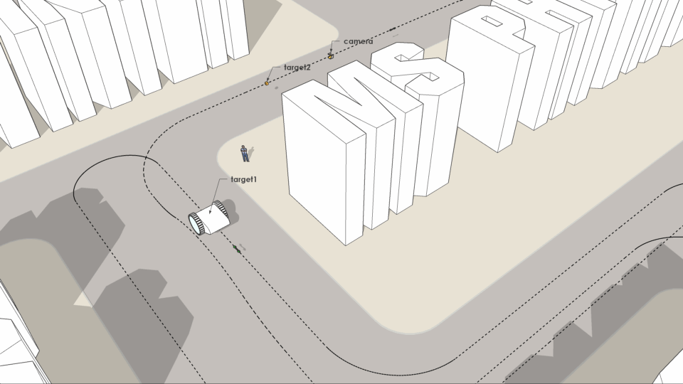

              Example 5: Camera and target movement.
              Different movement paths are defined for the camera and the target object.
              The speeds of the camera is again controlled with Slider Controller.
              You can test it with the attached file.
              MSP-Tut_CamCurvyP_MovingT_P5.skp
              • F
                faust07
                Example 6: Camera and target on the same line - fly through animation.
                The same movement paths is defined for the camera and the target object.
                The speed of the camera is controlled with Slider Controller.
                The target speed is automatically the same.
                You can test it with the attached file again.
                MSP-Tut_Cam&Target_on_CurvyPiston_P6.skp
