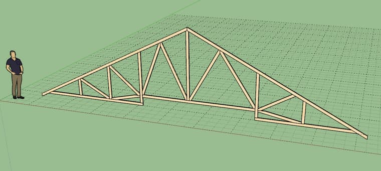

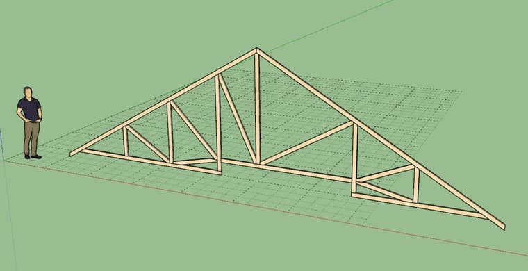

        Version 3.6.8 - 04.07.2025
        • Enabled square cut top chord tails for the following truss types: common, attic, scissor and cathedral.
