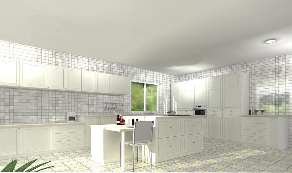

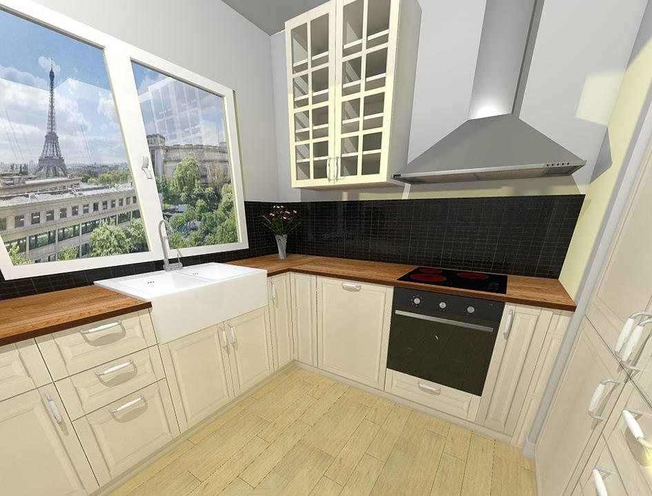

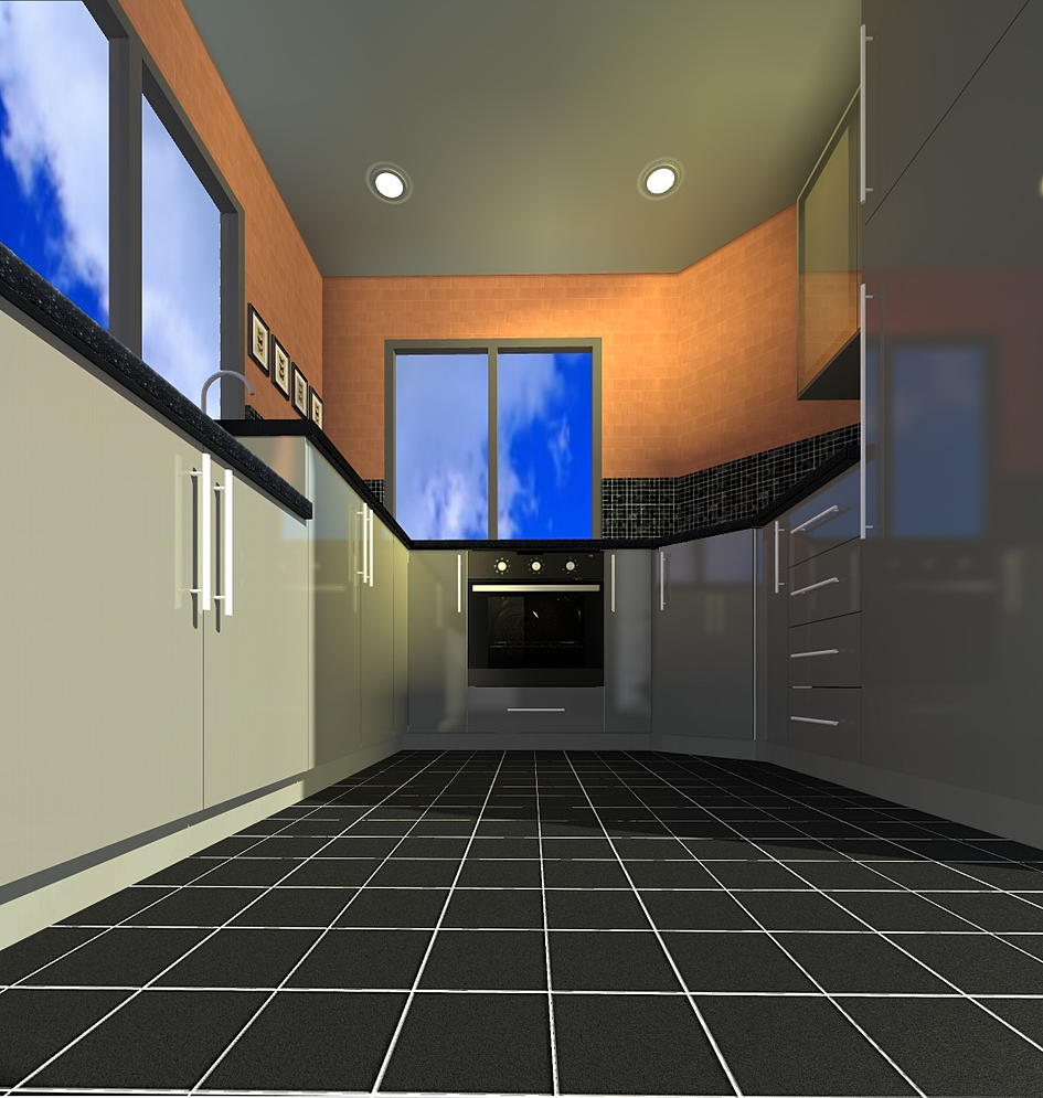

                    A vos ordres 😄
                    http://static.wixstatic.com/media/82ae55_233e178f88a24c7fa51f46d6cf31d306.jpg_srz_945_719_75_22_0.50_1.20_0.00_jpg_srz
                    http://static.wixstatic.com/media/82ae55_be74157ce4004ed38f5fadd5841239de.jpg_srz_945_995_75_22_0.50_1.20_0.00_jpg_srz
                    http://static.wixstatic.com/media/82ae55_d09595450c3a439fb84cb93c49b16612.jpg_srz_945_562_75_22_0.50_1.20_0.00_jpg_srz
                    [b:8wt9py2i]* Nouveau !!![/b:8wt9py2i] Découvrez notre nouveau Plugin [url=http://www.composant-dynamique.com/:8wt9py2i][color=#40FF00:8wt9py2i]C[/color:8wt9py2i][color=#77FF00:8wt9py2i]l[/color:8wt9py2i][color=#ADFF00:8wt9py2i]i[/color:8wt9py2i][color=#E4FF00:8wt9py2i]c[/color:8wt9py2i][color=#FFDB09:8wt9py2i]k[/color:8wt9py2i][color=#FF921B:8wt9py2i]-[/color:8wt9py2i][color=#FF492E:8wt9py2i]C[/color:8wt9py2i][color=#FF0040:8wt9py2i]u[/color:8wt9py2i][color=#ED2577:8wt9py2i]i[/color:8wt9py2i][color=#DA49AD:8wt9py2i]s[/color:8wt9py2i][color=#C86EE4:8wt9py2i]i[/color:8wt9py2i][color=#AD77FF:8wt9py2i]n[/color:8wt9py2i][color=#8965FF:8wt9py2i]e[/color:8wt9py2i] [color=#4040FF:8wt9py2i]2[/color:8wt9py2i][/url:8wt9py2i], pour créer vos cuisines 3D !
                      On voit rarement une cuisine comme la photo 2 à moins de s'être ramassé la margoulette! 💚
