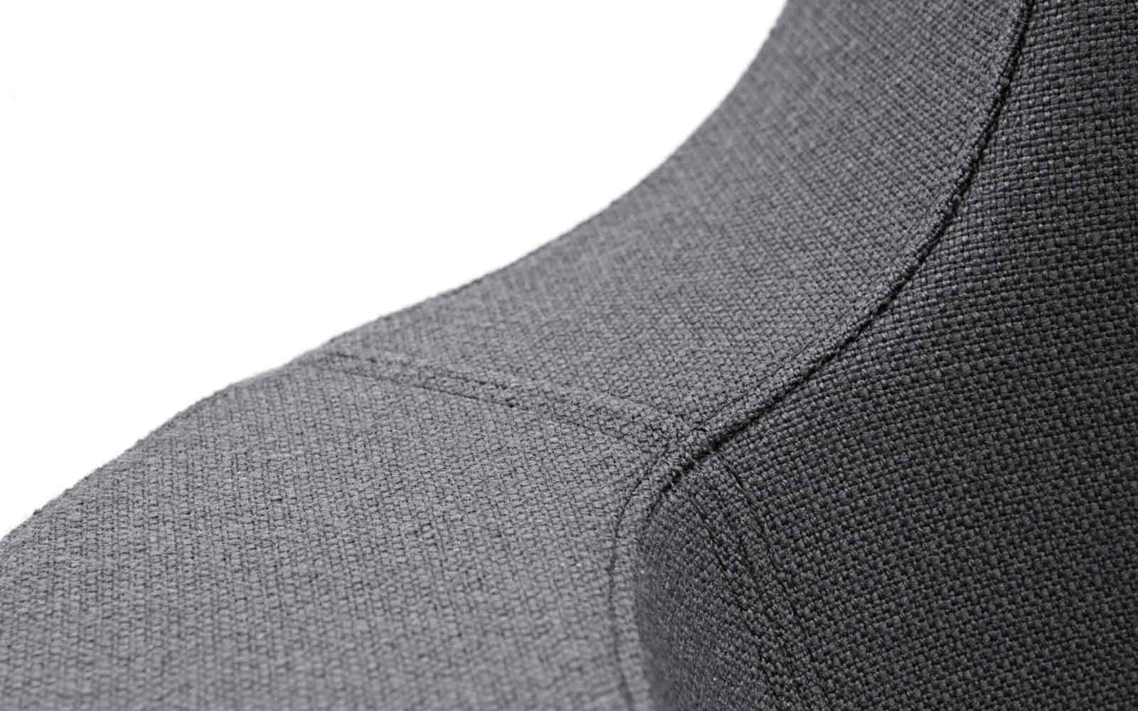

                                      Safa
                                      why make this a different edges?
                                      http://s23.postimg.org/4fzzehpob/0pcom_77364_Adams_leather_sofa_tif_72dpi.jpg
                                      2
                                      http://www.normann-copenhagen.com/products/~/media/Product Pictures/ONKEL/602905_Onkel_Sofa_DarkGrey_Stitch_Detail.ashx
                                      3
                                      http://st.houzz.com/simgs/08512e670138b968_4-1981/modern-sofas.jpg
                                      http://www.lafurniturestore.com/media/catalog/product/cache/1/image/9df78eab33525d08d6e5fb8d27136e95/A/s/Aston---Modern-Leather-Dark-Grey-Sectional-Sofa_DSC_3686.jpg
                                      4
                                      http://img.modern.co.uk/images/products/Belmont Corner Sofa Dark Grey_A_WWP-5.jpg
                                      • alvisA Offline
                                        alvis
                                        Hello Safa. You want to modeling furniture seams with Sketchup, as in the pictures? I can cheer you. With Sketchup it is possible to do! But until now, no one does it. And no tutorial on this issue. Why? Therefore, it is very difficult. Such modeling is not worth the money. Sketchup has a different concept. Lines, lines, and primitive shapes with friendly user interface. So the question is, why you need such a level of detail?
                                        Continues the lessons as I do it. Maybe you'll see something useful ...
