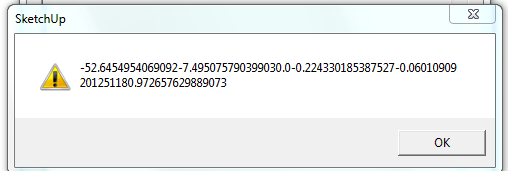

      I am having issues in adding two points - precisely a point and a vector. From what I have read this should be possible using the addition operator +, so that
      new point = point + vector
      In my code I have two vectors m and v. When I show them with UI.messagebox I can see that they are three elements arrays, but when I write m+v the output is actually a string concatenation.
      Am I missing some thing?
      I know could use [m.x+v.x,m.y+v.y,m.z+v.z] but the other solution is much more elegant and clear.
      Thanks a lot for any help.
      Ruggiero

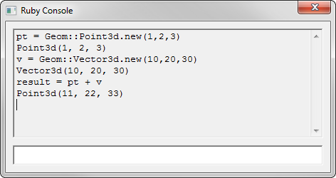

          From the Ruby Console:
          <span class="syntaxdefault"><br />pt </span><span class="syntaxkeyword">=</span><span class="syntaxdefault"> Geom</span><span class="syntaxkeyword">;;</span><span class="syntaxdefault">Point3d</span><span class="syntaxkeyword">.new(</span><span class="syntaxdefault">1</span><span class="syntaxkeyword">,</span><span class="syntaxdefault">2</span><span class="syntaxkeyword">,</span><span class="syntaxdefault">3</span><span class="syntaxkeyword">)<br /></span><span class="syntaxcomment"># => Point3d(1, 2, 3)<br /><br /></span><span class="syntaxdefault">v </span><span class="syntaxkeyword">=</span><span class="syntaxdefault"> Geom</span><span class="syntaxkeyword">;;</span><span class="syntaxdefault">Vector3d</span><span class="syntaxkeyword">.new(</span><span class="syntaxdefault">10</span><span class="syntaxkeyword">,</span><span class="syntaxdefault">20</span><span class="syntaxkeyword">,</span><span class="syntaxdefault">30</span><span class="syntaxkeyword">)<br /></span><span class="syntaxcomment"># => Vector3d(10, 20, 30)<br /><br /></span><span class="syntaxdefault">result </span><span class="syntaxkeyword">=</span><span class="syntaxdefault"> pt </span><span class="syntaxkeyword">+</span><span class="syntaxdefault"> v<br /></span><span class="syntaxcomment"># => Point3d(11, 22, 33)<br />&nbsp;</span><span class="syntaxdefault"></span>
          Is this not what you would expect to see?
