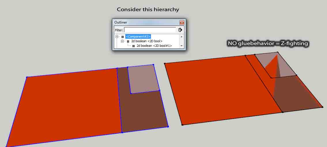

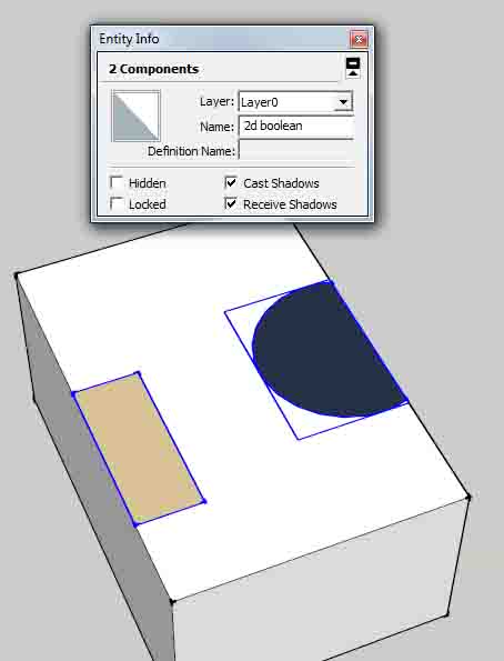

          I would like to add that different hierarchy's can be a solution to solve problem 2 maybe?
          For ex:

            Thanks for pointing me in the right direction, i will take a look at the pickhelper class. I like idea of creating a hierarchy of components to make them work there. Once again thanks for the help.
