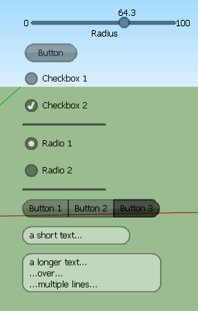

      In some situations the possibilities with SketchUp's built-in UI elements are easily exhausted, they are either too obtrusive (UI.inputbox), too hidden (VCB) or not flexible enough (Toolbar).
      In my case I needed only a few tool options that were not worth to have a webdialog or that would be rather confusing on a toolbar (where users expect tools).
      So I created these UI elements using the View.draw methods, nothing new, except that I made some sort of toolkit that can be implemented with only a few lines (example):
      class TestTool
      include AE;;GUI;;OnScreen
      def initialize
      window.layout=({;margin=>5, ;orientation=>;horizontal, ;align=>;center, ;valign=>;top})
      button = Button.new("Click Me"){
        UI.messagebox("Clicked!")
      slider = Slider.new("Radius", [0,100]){|value|
        @@radius = value
      window.add(button, slider)
      end
      end
      [https://bitbucket.org/Aerilius/onscreen-gui/wiki/Home](https://bitbucket.org/Aerilius/onscreen-gui/wiki/Home)
      More widgets can be added and the style can be changed with a CSS-like syntax.
      ![sketchup_css.png](/uploads/imported_attachments/S1gZ_sketchup_css.png)

                                  Here's how it looks on my cheap laptop. Do the sliders work? They did not work for me. It was a little slow with all 3 themes shown. When I commented out all but the native theme, it was better. I wouldnt expect the average plugin to use anywhere close to the number of widgets in the test tool, so performance wouldn't be an issue.

                                        Ok now how to use it. I have played around a bit with the testGUI.rb trying to figure out how to get the value from the widget. The slider example seems to emply that variable value should be the current value of the slider but it contains something like "pos(84.0,19.0,-1.0)flags0".
                                        http://sdmitch.blogspot.com/
                                        • A Offline
                                          Aerilius
                                          That's a bug! (the raw data of the event and where the slider was clicked)
