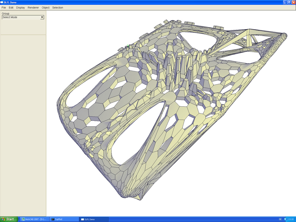

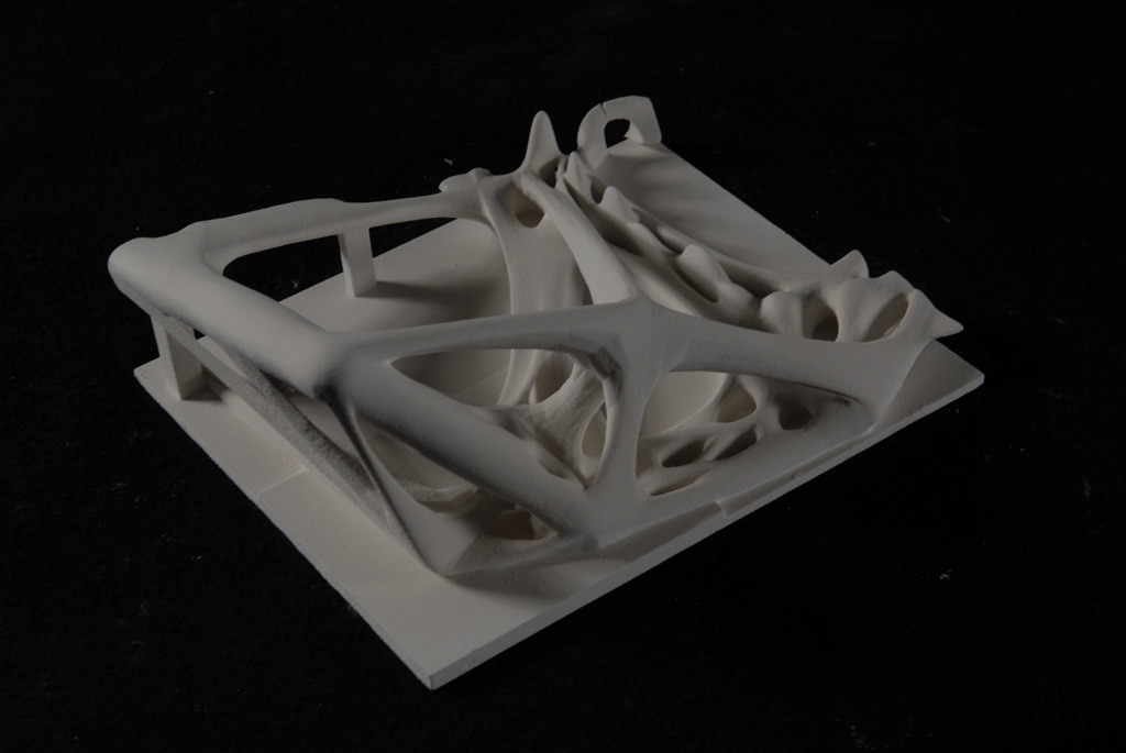

            Sinon un programme gratuit qui fait ce genre de bidule : TopMod modeleur Topologique 😉
            Que l'on subdivise!
            http://4.bp.blogspot.com/_cV0R6ebWS3c/RqDUopD3uUI/AAAAAAAAAIA/Bzjew7pz0UQ/s1600/topmod-screenshot.jpg
            http://4.bp.blogspot.com/_cV0R6ebWS3c/RqDWNpD3ueI/AAAAAAAAAJQ/WVZidFKZxFM/s1600/3d-print.JPG
