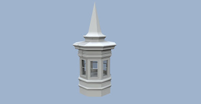

                    • M Offline
                      museummaker
                      Great comments everyone, I appreciate your time and input. I definitely need to work on my PS skills, I have only tapped the surface of what you can do in post processing, I spend a lot of time fidgeting with the render when sometime things can just as quickly be fixed with a few clicks in photoshop.
                      Richat-- just beginning to tap into manipulating nxtimages, the haze feature looks like it may come in useful for giving depth.
                      I'll post more soon, spent a little time modeling the tower that goes on top. 🤓
                      http://lh6.ggpht.com/_Mbz1E6DAT2U/TJpUb27YEfI/AAAAAAAAEIA/1Yflcu3OWJY/s400/towerrender.jpg
                      Thanks for the help
