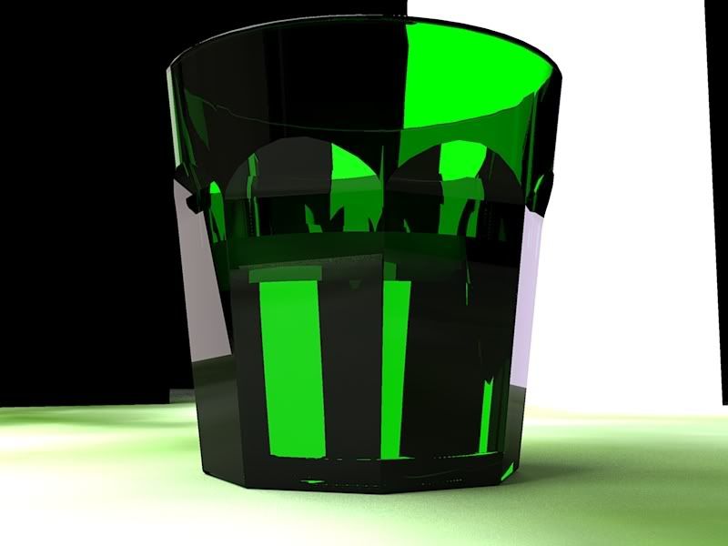

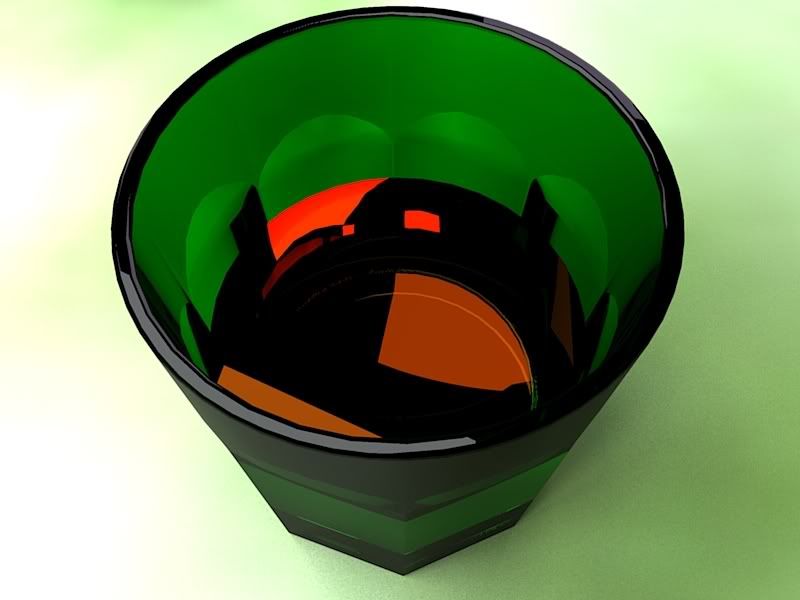

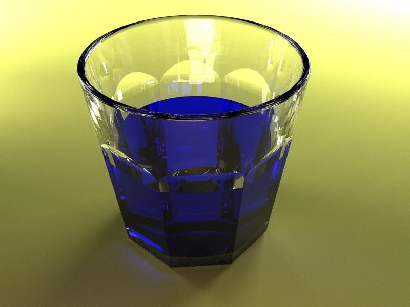

      Studying rendering with Kertkythea. (if I'm not completely new, I'm still very young with it)
      difficulty
      -to light the fluid inside the glass
      -to give a not so clean glass touch
      -to avoid to light excessively the soil
      -to keep external faces not reflecting to much lights so that materials are fading

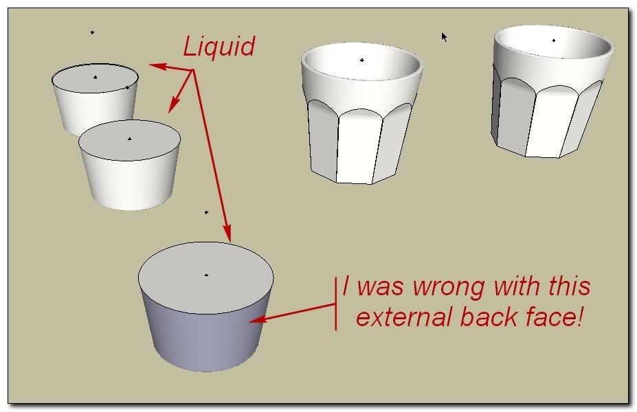

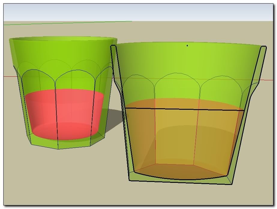

          Direction of surface normals (SU white faces) is crucial. Remember to apply material on SU white face.
          in Glass&LiquidWe have to indicate the direction of the geometry faces normals (refering to "front face" and "back face" in SU). Glass and liquid always have to point their normal outwards (front face)... If you experience problems, the direction ef the normals (faces) is probably the first place to look.
          --> As you can see, I was not far from the recommendations but had missed to turn all the liquid external faces white.
          http://i274.photobucket.com/albums/jj245/Spendauballet/KerkyThea/FacetedGlassSU001_th.jpg
          http://i274.photobucket.com/albums/jj245/Spendauballet/KerkyThea/FacetedGlassSU002_th.jpg
          We need to assign a IOR (index of refraction) value that corresponds to the material. In this example we have Glass which have a IOR between 1.5 and1.7 and we have water which have a IOR of 1.33.

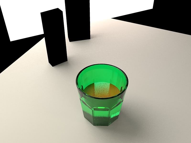

          Are your talking about: Fog/> absorption (which I was not able to access with the dielectric material included in the standard set) Or are you talking about: Reflectance-Transmittance/> refraction? I have given some color to the liquid using this one.
          The results are encouraging. 😄 (the liquid is now easy with transparency)

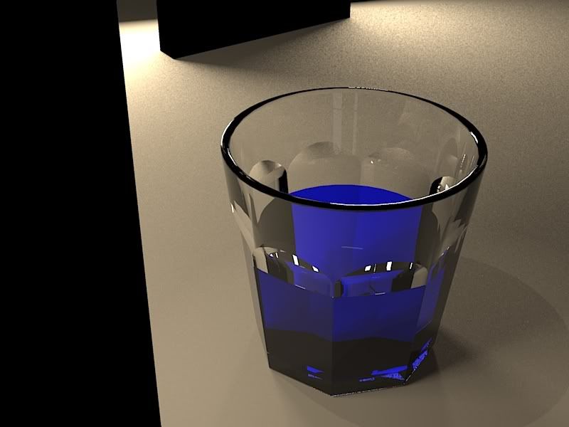

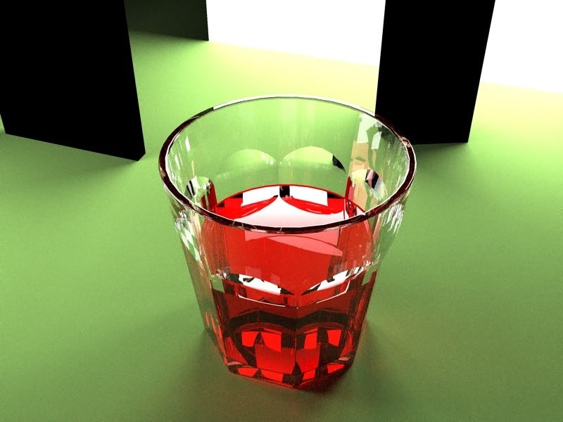

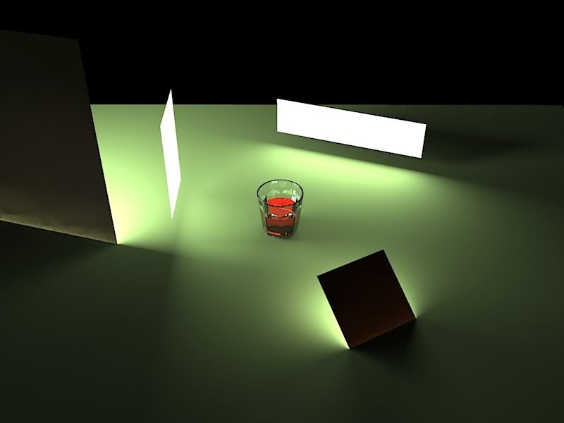

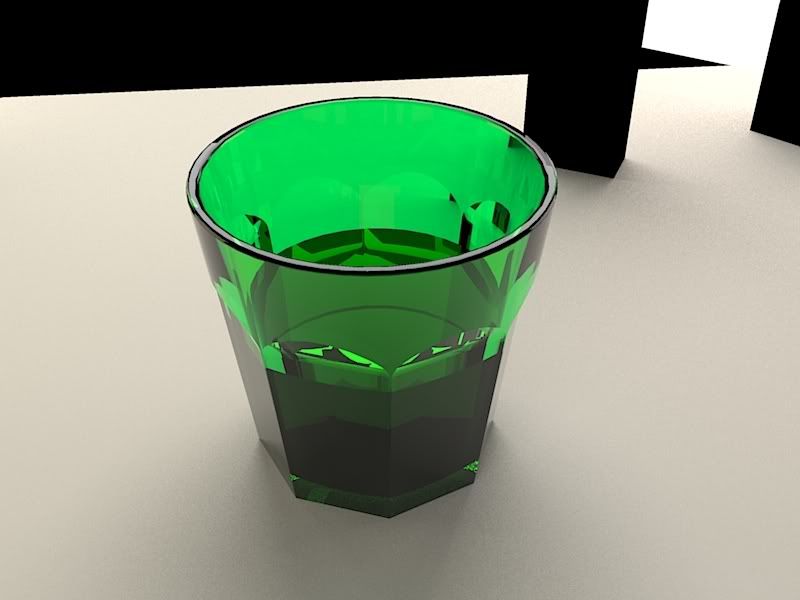

          An example of studio:
          http://i274.photobucket.com/albums/jj245/Spendauballet/KerkyThea/FacetedGlass_020B_800_th.jpg
          Preset 20. MLT/BPT is best for this task, if multiple light sources like Sun/point/spot and mesh lights are used. Pure MLT will do fine if HDR and/or mesh lights are used. Also photon mapping with caustics will work, but usually settings will need some fine tune.

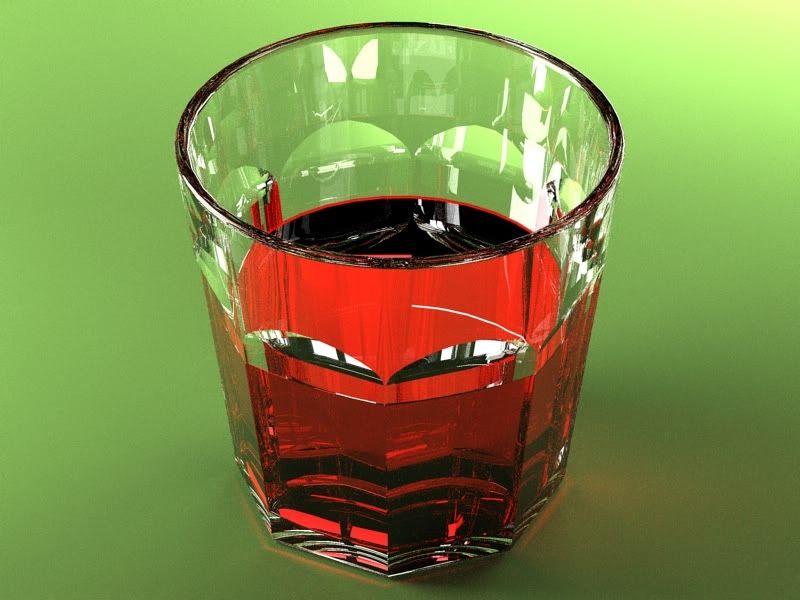

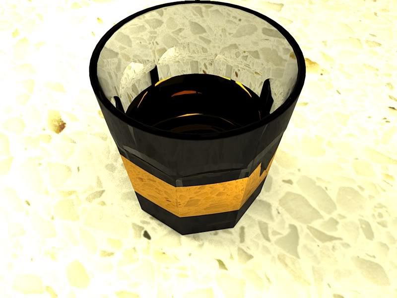

          👎 But I'm half convinced by MLT/BPT ❗ ❓ >> see pictures below. MLT add a lot of thin elaborated details but the picture is granulous, parts of material are faded out .. What do you think about?

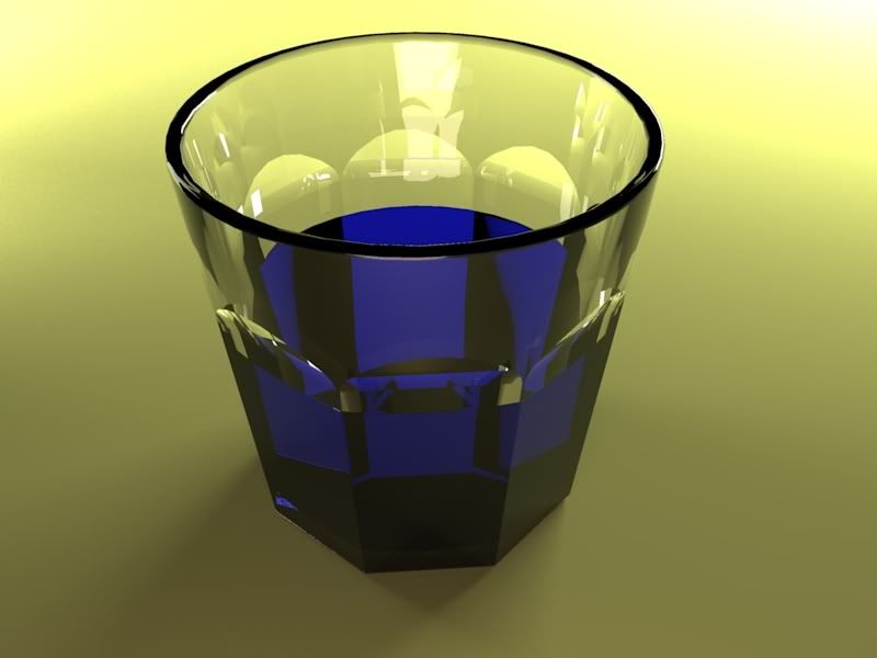

          Basic PhotonMapping:
          http://i274.photobucket.com/albums/jj245/Spendauballet/KerkyThea/FacetedGlass_019_800_th.jpg
          Elaborated PhotonMapping with caustics (preset 12 & 31')
          http://i274.photobucket.com/albums/jj245/Spendauballet/KerkyThea/FacetedGlass_019_800PhotMap_12_th.jpg

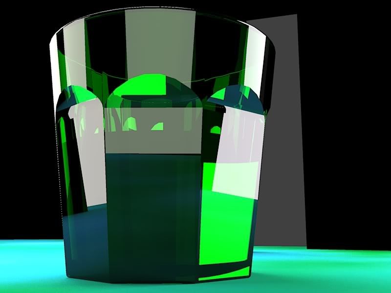

          Metropolis Light Transport MLT/BPT (preset 20 & 79passes & 52')
          http://i274.photobucket.com/albums/jj245/Spendauballet/KerkyThea/FacetedGlass_019_800MLT_th.jpg

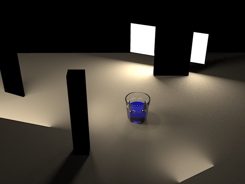

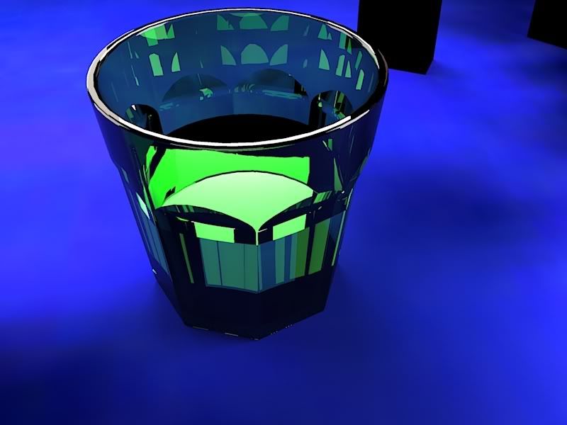

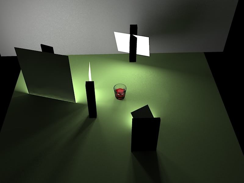

          another try, another studio:
          http://i274.photobucket.com/albums/jj245/Spendauballet/KerkyThea/FacetedGlass_021B_800_th.jpg
          (PhotonMap preset07)
          http://i274.photobucket.com/albums/jj245/Spendauballet/KerkyThea/FacetedGlass_021_800PhotMap_07_th.jpg

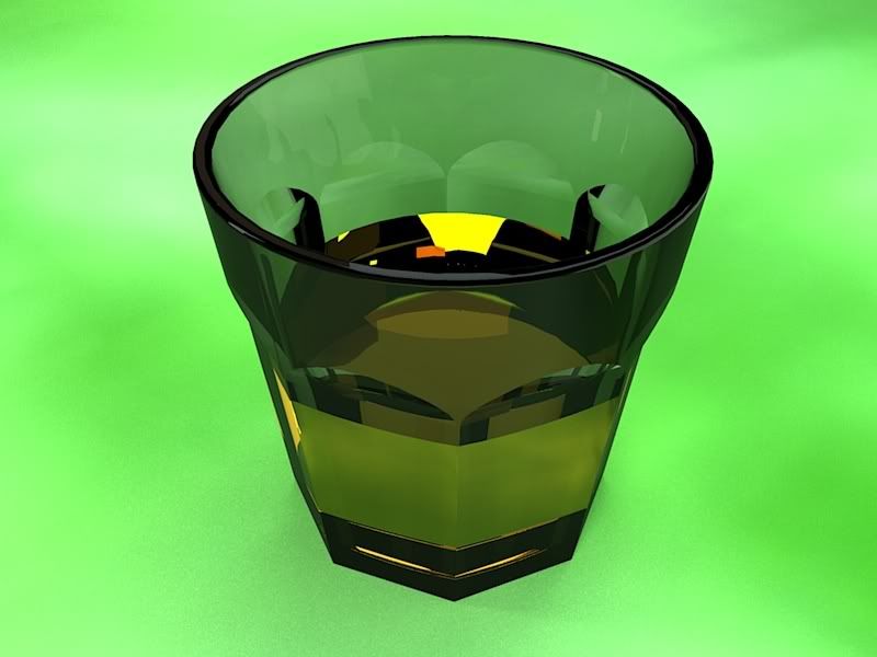

          PS: a night have passed and I drop a new look onto the previous results. Metropolis Light Transport is definitively more sensible. For the quality picture, I have just to try 200passes & (about)2 hours rendering...

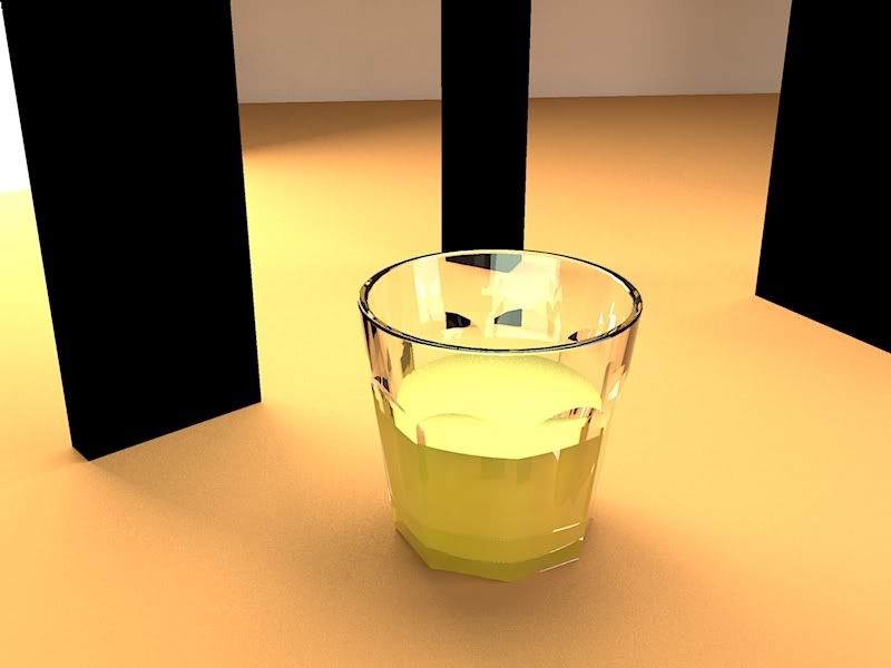

                Further investigations...
                http://i274.photobucket.com/albums/jj245/Spendauballet/KerkyThea/FacetedGlass_022B_800_th.jpg
                http://i274.photobucket.com/albums/jj245/Spendauballet/KerkyThea/FacetedGlass_023_800_th.jpg
                Metropolis N°20 MLT/BTP, Pass 70 in 1h57"4'
                Re: I had made a hole on the soil, dimensioned as the exact footprint of the glass. This is why we see that deep black disk into the liquid. I have also tried to enlight the Glass by a spot beneath on the Glasse axis, oriented vertically. The result was not successful. I have to understand this.
                http://i274.photobucket.com/albums/jj245/Spendauballet/KerkyThea/FacetedGlass_024_800MLT_th.jpg

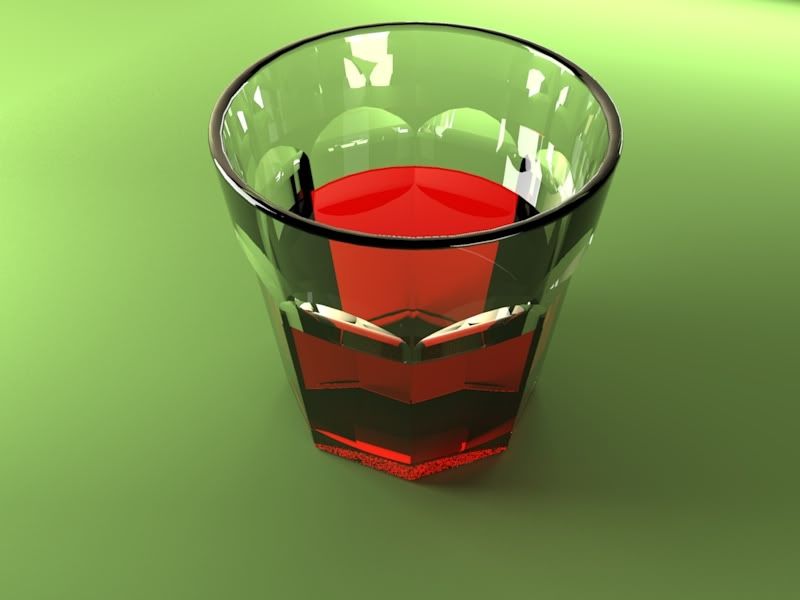

                @notareal said:

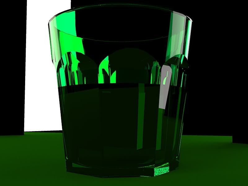

                In Kerkythea, when rendering dielectric materials (glass, liquid...) with default photon mapping settings, one might see some parts with refection or refraction gone black.
                Exactly what I experience and what I'm fighting with..

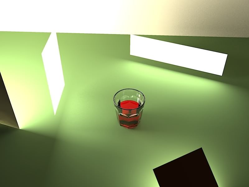

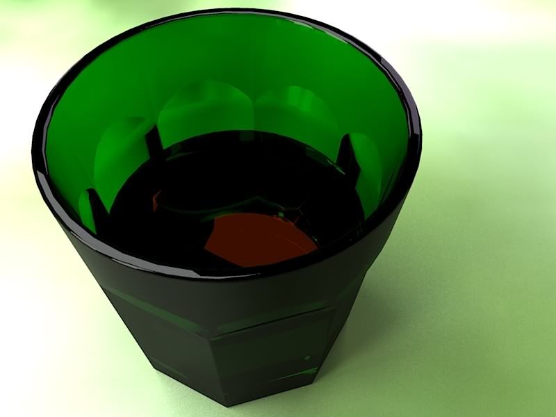

                http://i274.photobucket.com/albums/jj245/Spendauballet/KerkyThea/FacetedGlass_025B_800_th.jpg
                PhotonMap basic settings: quick (N°3)
                http://i274.photobucket.com/albums/jj245/Spendauballet/KerkyThea/FacetedGlass_025_800_th.jpg
                Metropolis N°20, Pass 87 in1h59'19"
                http://i274.photobucket.com/albums/jj245/Spendauballet/KerkyThea/FacetedGlass_026_800MLT_th.jpg
                PhotonMap-Fine + AA 0.3 (N°08) in 0h20'7"
                http://i274.photobucket.com/albums/jj245/Spendauballet/KerkyThea/FacetedGlass_026_800PM08_th.jpg
                Dear Notareal, can't you take my model and made one or two of your (experienced) own rendering? It would be very pleasant to follow a lesson .. (If your spare time can managed this 😕 )

                  Simon.
                  your glass is 4m tall!?!
                  this will NOT render correctly.
                  scale must be accurate for accurate renders!

                      😳 😳 😳 forgotten this!!
                      http://i274.photobucket.com/albums/jj245/Spendauballet/generalPicts/th_zScan_008_500jpg.jpg
                      Here is a rectified skippy:FacetedGlassSCF_Rectif.skp
