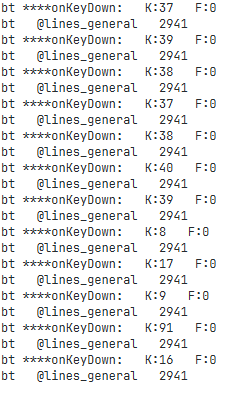

      i face a strange problem:
      while transferring my plugin to skp2025
      the ruby-console shows all flags with value 0
      for any key hit (notebook and external keyboard).
      so nothing works in the plugin.
      has anybody any idea, what is causing this?
      thanx a lot. i am rather desparete now....
      stan
      ruby-console after hitting some keys:
      puts "bt ****onKeyDown:   K:#{key}   F:#{flags}"

        FYI, I did report this to Trimble.
