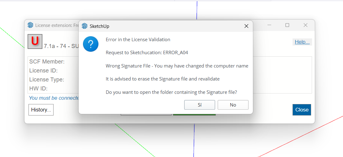

                                          LEADERFIT3D Newcomers @Rich O Brien
                                          @Rich-O-Brien
                                          Bonjour, voici un exemple

                                            @LEADERFIT3D
                                            You have a few items to update
                                            • Librfredo is now 15.5a: https://sketchucation.com/pluginstore?pln=LibFredo6
                                            • Sketchucation Tools is now 5.0.3: https://sketchucation.com/plugin/696-sketchucationtools
                                            Restart SketchUp after updating and try licensing again.
                                            If the error repeats it maybe related to your device name. Special character like áéíóú etc are not allowed. Please rename your device to only use alphanumeric characters.
                                            If you have recently reinstalled your OS this can raise errors. If so, please go to C:\Users\SomeName\AppData\Local\SCF Licenses and delete the SCFLicenseSignature - DO NOT MODIFY OR DELETE.txt file.
                                            Restart SketchUp and try again.
