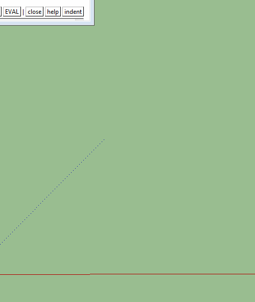

        That's because you can never be sure of the order of entities in a selection. You would think that they would appear in the order they were created but that is not the case as this little demo will illustrate. The second edge drawn somehow is the first entity in the selection.
