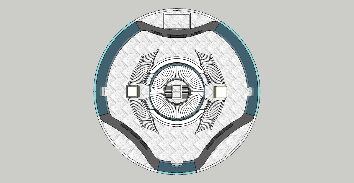

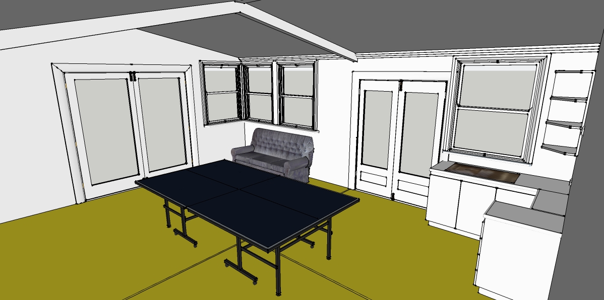

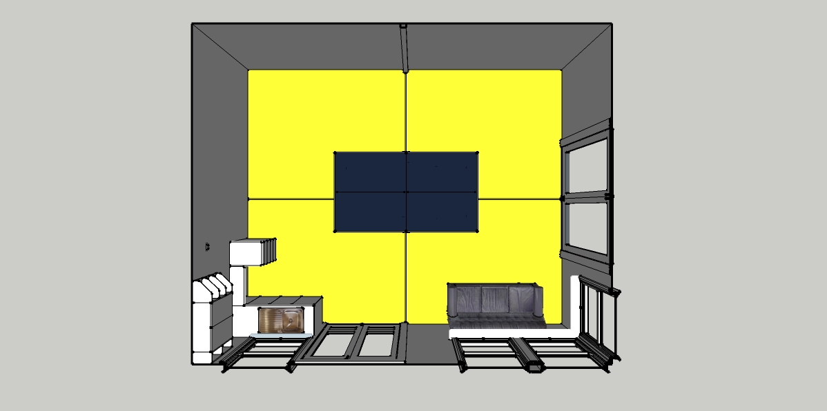

        Furthermore I'm currently design a room that will be my study and architectural office, for models, computer, scanner, printer etc.Please give me lots of advice on anything I should add or be aware of.
      The floor plan is below + one scene

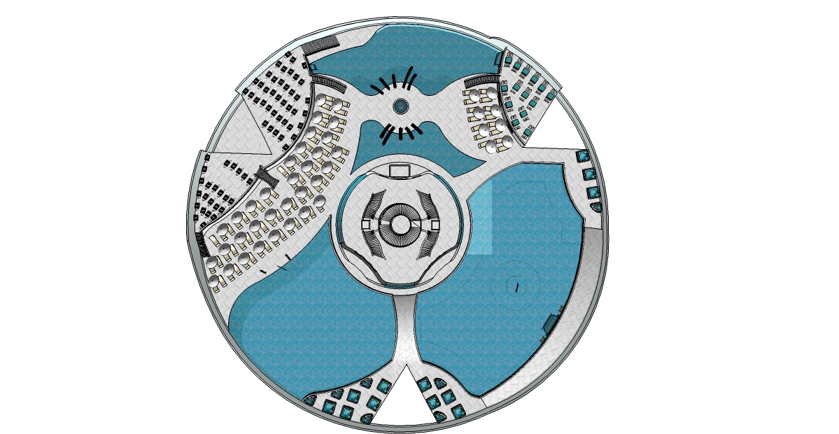

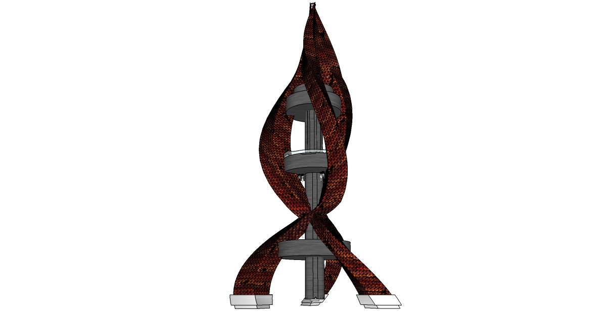

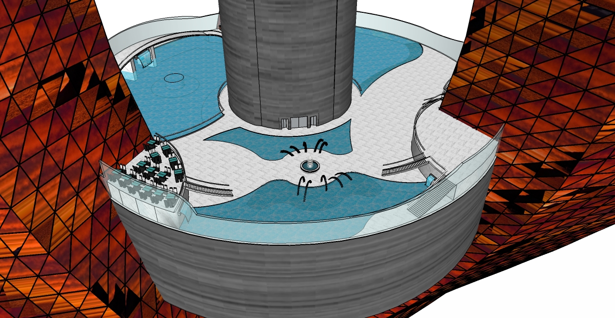

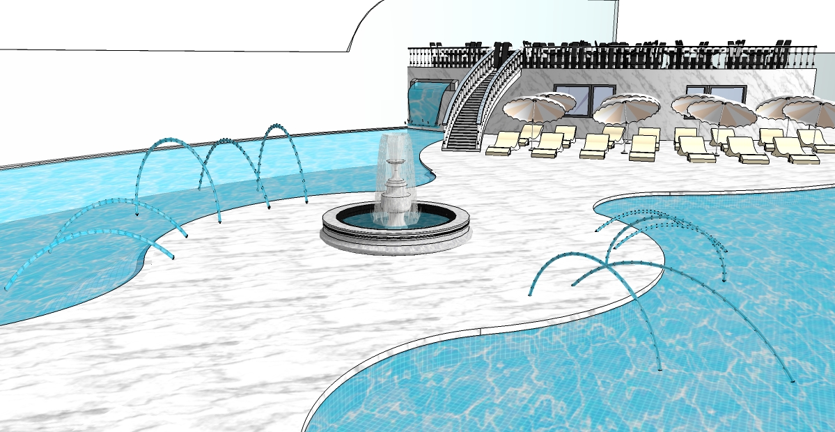

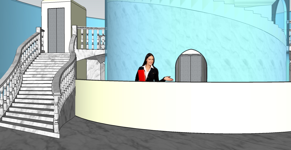

      P.S. Can you also rate/comment/give advice on my first design of a Hotel
      Here are some pics!
      (sorry no renders 😞 )

                So the room your designing. Are you thinking this is where you'll spend a lot of time in architecture school or is this something else? In school you'll be provided these these things in a communal studio with your classmates where you'll work feverishly many times staying up all night to get your designs finished but it will be one of the best times of your life. You wouldn't want to sacrifice that by doing all of your work at home.
