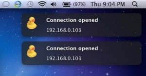

      • A small bar on the top right corner of Sketchup that shows a notification when an event has occurced . Example, ON SWITCHING tool TO CIRCLE, "it must show a text "CIRCLE SELECTED" there.
        On swithing to push/pull( "PUSH PULL ACTIVATED")
      (Those who've used Growl Notifications http://osxdaily.com/wp-content/uploads/2010/05/disable-growl-notifications-in-cyberduck-300x157.jpg will understand what i mean)
