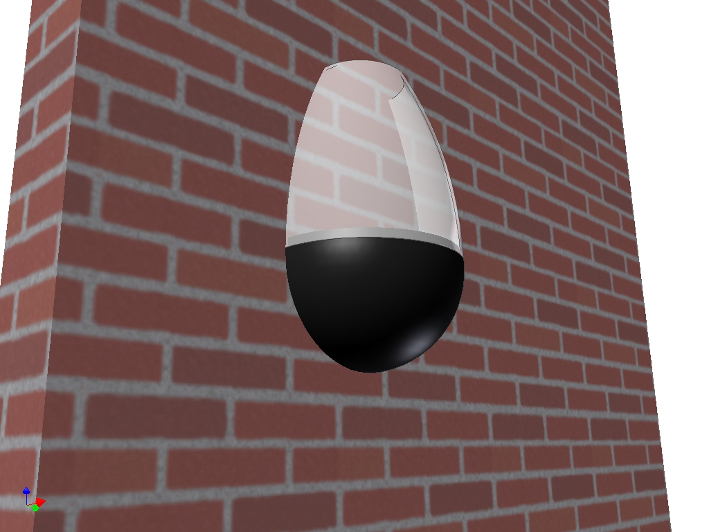

                                            Ecuadorian
                                            Sky portals only allow for more skylight to enter the room. 😎 If you're using the physical sky this will just produce a small blue cast in your kitchen.
                                            The problem, as I see it, is that unless you have some direct light reaching the ceiling, it will look relatively dark. A hanging lamp, for example, showers the ceiling with direct light, but the kind of fixtures you're using do not. How about adding a couple of apliqués?
