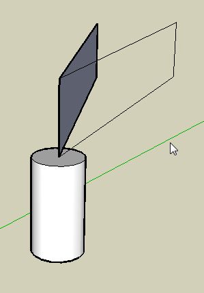

            @henkh said:
            [attachment=0:cwr9r2ed]<!-- ia0 -->joint.jpg<!-- ia0 -->[/attachment:cwr9r2ed]
            CPhillips, thanks for your reply, but the document doesn't help me with the problems I described. And I don't experience these problems in Win XP either. It's only in Win Vista where I can't build a working model. To explain the joint problem: the attached image shows what happens if I try to place a joint on a cylinder.
            Regards, HenkH
            Hmm. Looks like a bad install. My guess is the plugins\sketchyphysics\joints folder is missing or the contents are screwed. You should try reinstalling. Make sure it is going to the right directories.
            If that doesnt work. Open the ruby console and try creating a joint. It should print some sort of error in the console. Cut and paste that error here.
