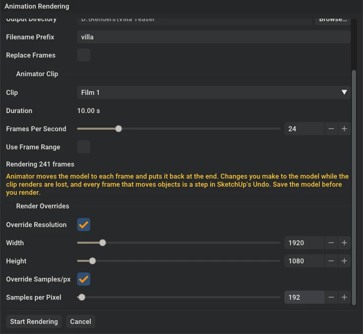

<li>Click <strong>Start Render</strong>, then <strong>File &gt; Render Animation...</strong> in Rayscaper.</li>
<li>Under <strong>Animate</strong>, choose <strong>Animator Clip</strong> and pick the clip.</li>
<li>Render a preview first: override the resolution to 640 x 360 and the samples to 16. It shows the timing and the camera path in a few minutes.</li>
<li>Then render the final frames. The example took about two hours at 1920 x 1080 with 192 samples per pixel on an RTX 3080, half a minute a frame.</li>
</ol>
<p dir="auto">Animator moves the model to each frame in SketchUp, Rayscaper renders and saves it, and at the end Animator puts the model back as it was. With <strong>Save Video</strong> on, Rayscaper encodes the frames into an MP4 for you.</p>
<p dir="auto"><img src="/assets/uploads/files/1792956745778-rayscaper_render_animator_clip.png" alt="Rayscaper's Animation Rendering dialog with the Animator Clip Film 1: 10 seconds at 24 frames per second, 241 frames, rendered at 1920 by 1080 with 192 samples per pixel. A note says Animator moves the model to each frame and puts it back at the end." class="img-markdown  img-fluid" width="720" height="662" /></p>

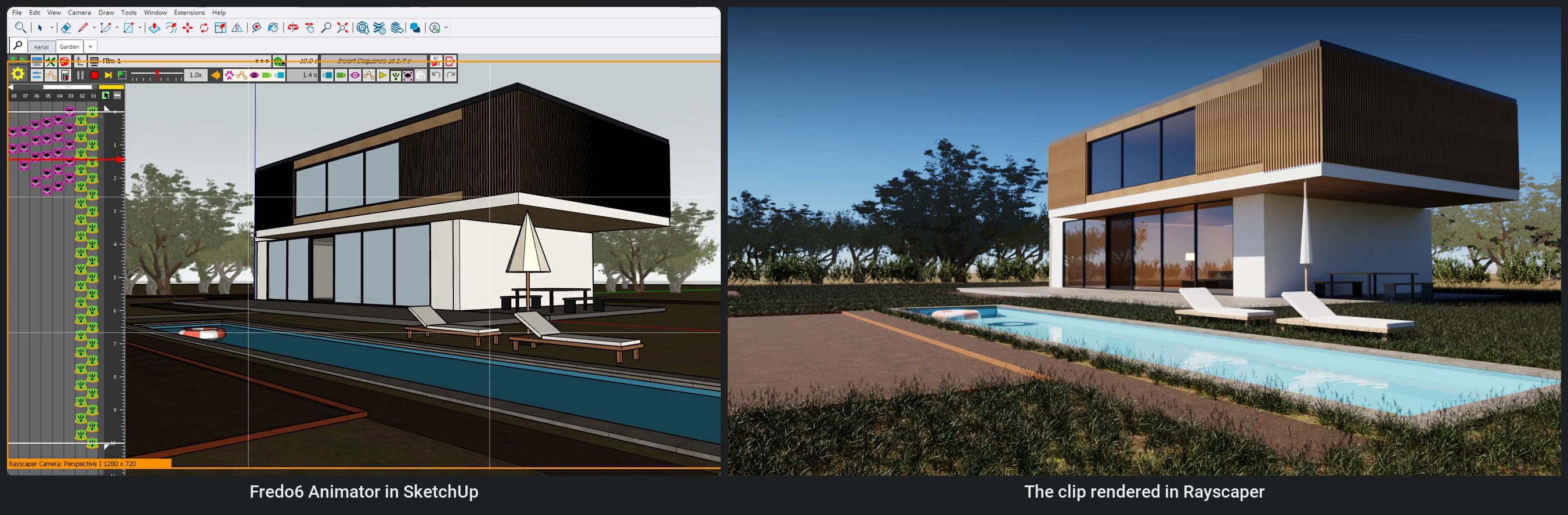

<p dir="auto"><img src="/assets/uploads/files/1792956745865-animator_clip-resized.png" alt="Left: SketchUp with the Fredo6 Animator timeline next to a modern two-storey villa with a pool, a float and a folded parasol. Right: the same clip rendered photorealistically in Rayscaper, the villa in warm sunlight behind a blue pool." class="img-markdown  img-fluid" width="2702" height="888" /></p>
