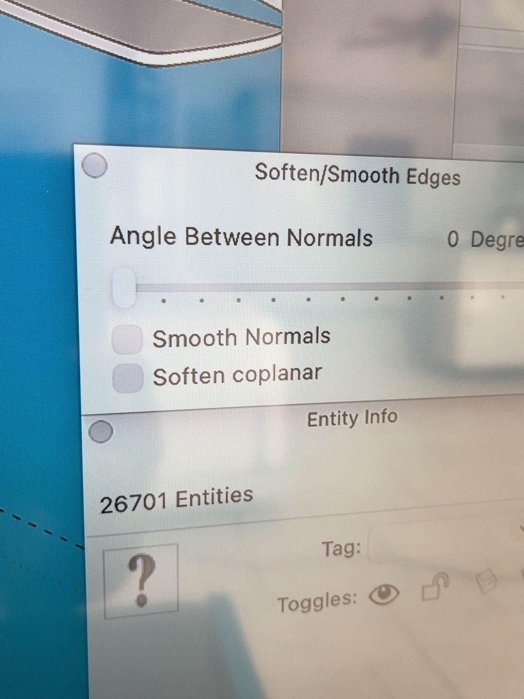

<?xml version="1.0" encoding="UTF-8"?><rss xmlns:dc="http://purl.org/dc/elements/1.1/" xmlns:content="http://purl.org/rss/1.0/modules/content/" xmlns:atom="http://www.w3.org/2005/Atom" version="2.0"><channel><title><![CDATA[Edges not showing]]></title><description><![CDATA[<p dir="auto"><a href="!%5Bimage.jpeg%5D(/assets/uploads/files/1792955470911-ff2bdd5b-d412-438d-94cc-5525b7e63619-image.jpeg)">link text</a>)))))<img src="/assets/uploads/files/1792955490504-faf7241a-5613-4fa2-85cf-4bf6dc439323-image.jpeg" alt="image.jpeg" class="img-markdown  img-fluid" width="1080" height="1440" /><br />
Why are the vertical lines not showing</p>

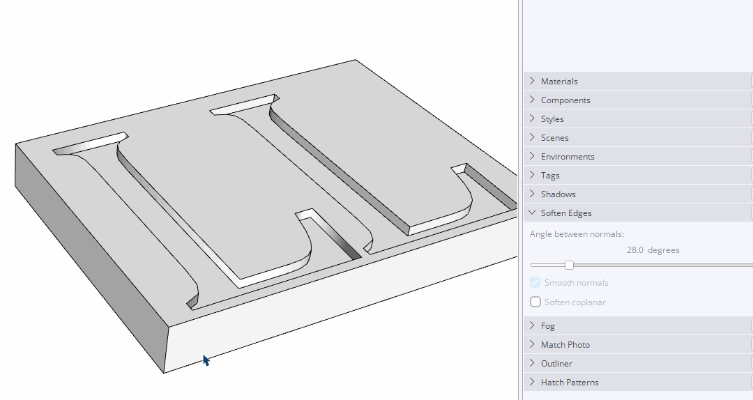

]]></description><link>https://community.sketchucation.com/post/1623220</link><guid isPermaLink="true">https://community.sketchucation.com/post/1623220</guid><dc:creator><![CDATA[panixia]]></dc:creator><pubDate>Sun, 25 Oct 2026 22:05:51 GMT</pubDate></item><item><title><![CDATA[Reply to Edges not showing on Mon, 26 Oct 2026 01:36:08 GMT]]></title><description><![CDATA[<p dir="auto">I expect the edges of the letters were welded. If they were it wouldn't matter what the softening angle was set to? Triple click on the geometry with the Select tool and then right click on it. Choose Soften/Smooth Edges. Set the slider to the default 20°.</p>
<p dir="auto">The edges of the L on the left were welded before using Push/Pull. The ones on the right were not.<br />
<img src="/assets/uploads/files/1792978550167-welded.gif" alt="Welded.gif" class="img-markdown  img-fluid" width="1080" height="574" /></p>

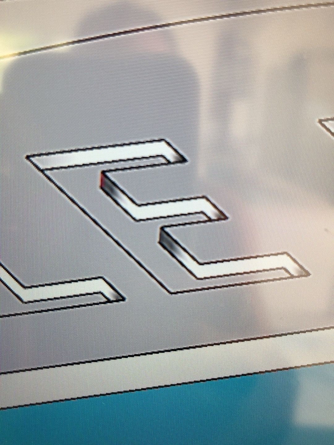

]]></description><link>https://community.sketchucation.com/post/1623219</link><guid isPermaLink="true">https://community.sketchucation.com/post/1623219</guid><dc:creator><![CDATA[Dave R]]></dc:creator><pubDate>Mon, 26 Oct 2026 01:36:08 GMT</pubDate></item><item><title><![CDATA[Reply to Edges not showing on Sun, 25 Oct 2026 19:16:03 GMT]]></title><description><![CDATA[<p dir="auto">I’ve only noticed this in the last few months. I pulled the outer surface down 1mm then the lettering down 0.4mm and got this</p>
]]></description><link>https://community.sketchucation.com/post/1623208</link><guid isPermaLink="true">https://community.sketchucation.com/post/1623208</guid><dc:creator><![CDATA[Leggy]]></dc:creator><pubDate>Sun, 25 Oct 2026 19:16:03 GMT</pubDate></item><item><title><![CDATA[Reply to Edges not showing on Sun, 25 Oct 2026 19:13:40 GMT]]></title><description><![CDATA[<p dir="auto"><img src="/assets/uploads/files/1792955614400-0c6c73ec-f714-4183-940d-b16c13ca6f49-image.jpeg" alt="image.jpeg" class="img-markdown  img-fluid" width="1080" height="1440" /></p>
]]></description><link>https://community.sketchucation.com/post/1623207</link><guid isPermaLink="true">https://community.sketchucation.com/post/1623207</guid><dc:creator><![CDATA[Leggy]]></dc:creator><pubDate>Sun, 25 Oct 2026 19:13:40 GMT</pubDate></item></channel></rss>
